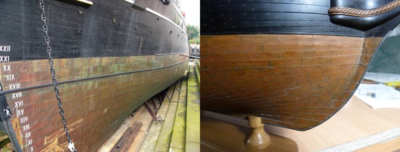

Thank you for your comment. I have already tried similar methods. I will talk about this later, but none of them suited me. Or rather, there is one better than all the others, but it is not the same as the desired remedy.

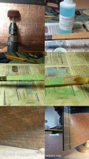

Part 2
In this section, I am showing my experiments with patinating copper sheeting to achieve the effect of natural copper oxidation. By the way, Dmitry Shevelev, in my opinion, best conveyed this effect. I have only somewhat approximated it so far, but I am awaiting the product that the master uses in order to replicate his result. But that will be discussed later, for now, these are the intermediate results—perhaps they will work for someone. >>> Here is the link <<< to the full text in my main build thread.

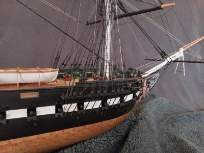

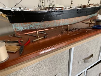

Here is a picture of my Flying Fish with the aged copper as per my method.
I also used the salt, vinegar (white) and ammonia method but was instructed to use an industrial strength (10%) ammonia. Depending on the ratio of each ingredient, you can push the result to the blue or green and change the texture of the finish. The attached picture is the Constructo Enterprise that I have been working on for 30 years (the instructions were about a page and a half, with a page and a half parts list.) I recently applied and antiqued the copper plate. The overall model will have a distressed look when complete.

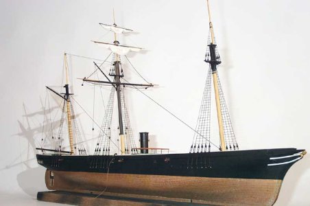

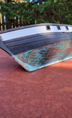

This model's sailed in salt water several times. The copper is uncoated tape from an electrical supply applied as individual plates. The greens are oxidation from being in the air.
View attachment 483178View attachment 483179

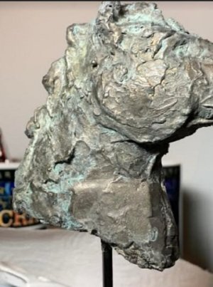

Hello friends. I make medium size sculptures. I have come up with my own methods and materials. One of the final processes of the sculpture making is the production of an imitation of the patina over the actual bronze statues. I am going to tell you what I use hoping it would be useful to you.
1. Put 1/2 teaspoon of copper sulfate crystals (CuSO4) into a little container. I use the little containers that come with sauces when one buys food to go.
2. Cover the crystals with boiling water, no more than that.
3. Wait until all or most of the crystals have dissolved in the water. You will have a saturated solution of CuSO4 with an intense pretty blue color.
4. This step is optional: add some drops of clear vinegar (acetic acid), preferably synthetic. From a chemical point of view the acidity would favor the oxidation reaction but I have found that I do not need it for my sculptures. Some acidity may be necessary with copper, though. You may test the process with a diluted solution of chloridric acid (ClH) to see if a stronger acid improves it. Be careful with this acid. I would recommend it only if you have experience and you know very well how to handle strong acids. Also, try to see what happens with no acid at all; only, water.
5. Apply the CuSO4 solution, small amounts at the time. Apply as many coats as necessary until reaching the desired effect. You may need only one, though.
6. Once the patina is dry you may apply a polymeric coating over it like varnish. I use Minwax Polycrylic (water based). The coat will protect the patina avoiding losing particles of oxide by friction and manipulation in general.
Hope this is useful or at least can guide you in the right direction.
