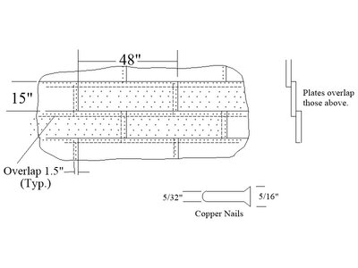

THANK YOU FOR YOUR POST. I agree with you that the plates in photos from every supplier that I have seen are out of scale and in some cases they protrude like rivet heads which looks even worse! Incorrectly sized laser cut circles can look just as out-of-scale if they are like those in post #9 above. A simple laser cut dot at the proper scales would be easier for the manufacturer and would look realistic. Subtlety is a good thing at times. The below sketch is based on information from Peter Goodwin in The Construction and Fitting of the English Man of War. The nails used were typically 5/32" with a head of about 5/16" so the size of the dents if made with a ponce wheel or lasered dots can be easily calculated. Note the spacing as well.
