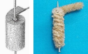

Just to point out the link that Donnie gave is the method I was doing and for the number of these I need to make to get even close to something realistic is in fact very tedious and time consuming. Although so far the results are not coming out to bad and with some trial and error I ended up working with some very fuzzy type yarn that once placed I was able to fluff up to produce a fairly good effect. I still may have to go that route and the question here was really to see if there was a smarter way to accomplish this than what I was doing. Still anyone that has a thought or idea I would love to hear it...
