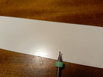

You can put a collar or a piece of tape on the drill bit to give you an indicator of when to stop drilling so you can make them a uniform depth. :)
I got "wheel collars" from an RC plane store. They are made in several sized by Du-Bro.
