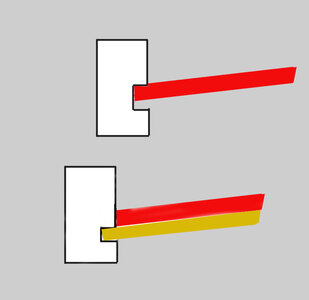

i was thinking if you cut the rabbit wide enough for 2 layers of planking you will have a gap between the first layer and the edge of the rabbit so you will need to wedge the end of the plank against the edge of the rabbet like the top drawing to keep that area open for the second plank
if you planked the hull and butt the first layer to the side of the keel then cut a rabbit it creates a tongue and grove thing.

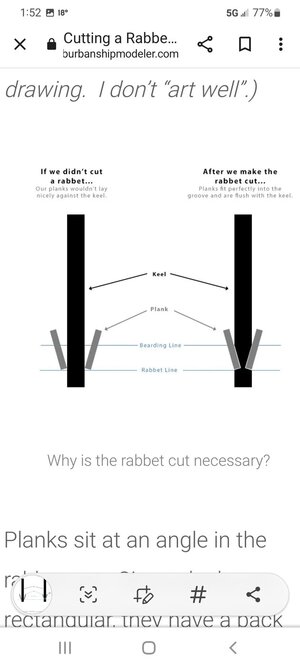

Drawing extracted from this online article.
"Moderators" if I can't post that link/drawing, please delete it.

Cutting the rabbet always confused me especially at the stern. This cleared it all up.
