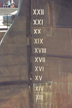

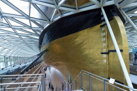

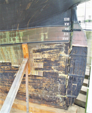

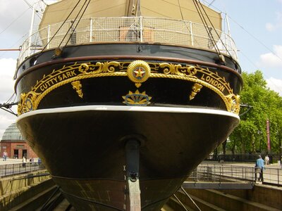

This photos is maybe helping most
take also a look at the pdf where you can find photos of the stripped counter structure - highly interesting

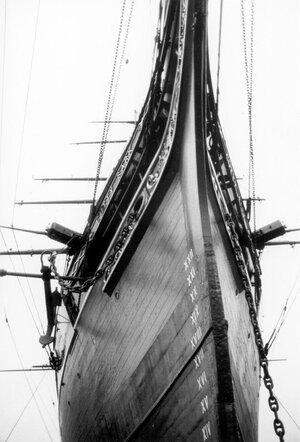

I like this one of the bow very much (not your search I know)
Thank you for the nice images everyone- very useful to reference to.
The problem I'm having is judging how much inflexion is needed on the planks that sweep in to meet the stern post and how they run up to meet the stern counter. The bulkhead spacing is quite large so the planks don't form the nice sweeping curves you see in the images at the moment. I am adding some in-fill and shaping that to give a smoother profile but it is quite difficult to visualise from 2D plans to 3D model the amount of shaping that I need to do.
I think I am going to have to go down to Greenwich and check out the 1:1 original sooner than later :)!
