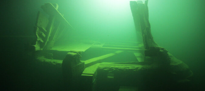

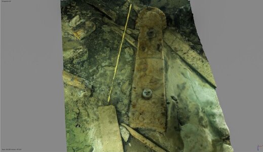

Transom of the Badewanne 1636; width at the top – 40 cm (photo by Jouni Polkko):

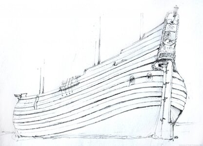

Visual reconstruction of the Badewanne 1636 by Niklas Eriksson:

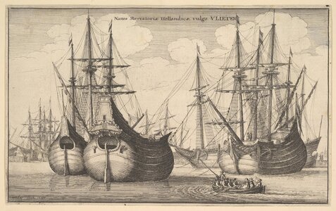

Wenceslaus Hollar, Naves Mercatoriæ Hollandicæ, vulgo VLIETEN, 1647:

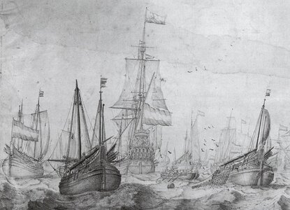

Dutch herring fleet drawn by van de Velde the Elder, depicting fluits all sporting extremely narrow transoms, very similar to the defensionsskib 1630 by David Balfour:

You do see the actual small superstructure on wrecks. For example the upper teansome of the 1636 fluyt in Finland found by the Baddewanne group and discussed in this thread.

Transom of the Badewanne 1636 (width at the top – 40 cm)"

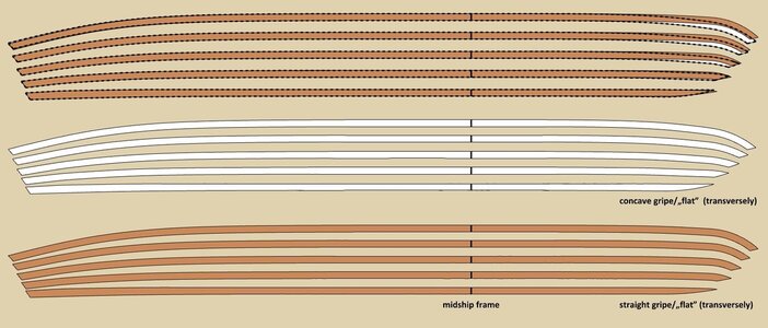

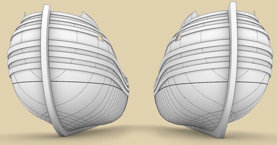

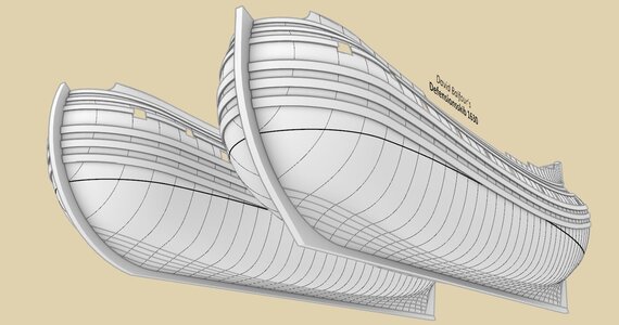

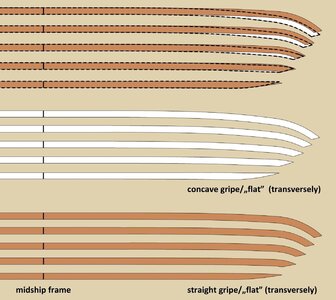

Back to the shape of the gripe. The renders below show two variants of the bow shape. On the right is the concave variant, on the left the straight one. The second variant, with straight cross sections, seems to have been more common after the archaeological finds. However, I personally think that the bottom-first method was flexible enough in this respect to achieve 'any' desired shape, and this was only dependent on the experience and skill of the shipwrights. Needles to say, different forms (sharper or fuller) being needed for ships performing different functions, and the most basic division relates to the military or civilian purpose of the vessel.
The comparison of the developed planks of the „flat” for both variants shows that the curvature of the planks in both cases is realistic and even quite similar, in fact it is even lesser and rather easier for the concave variant. Either way, the ability to properly pre-profile the planks in order to achieve the desired surface shape in this method was most likely already the domain of master-craftsmen, rather than journeymen and apprentices.
