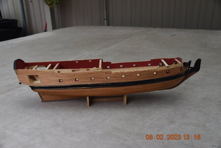

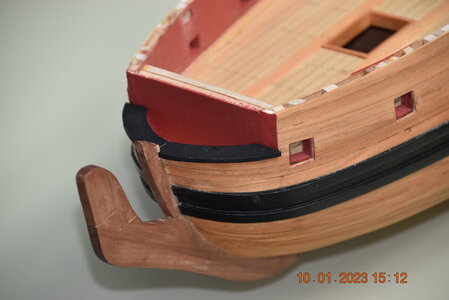

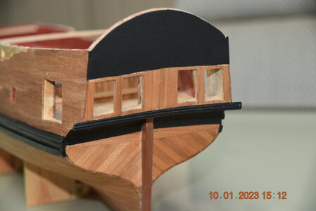

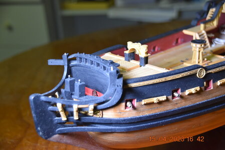

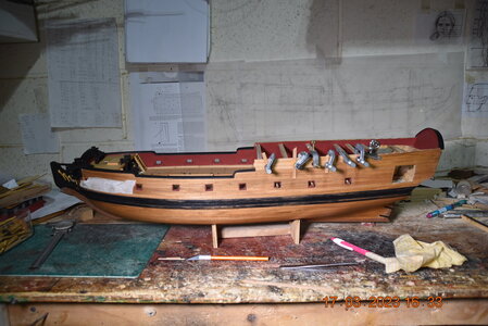

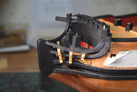

Some progress again after a long while... The forecastle is in preparation, as is the inside of the rear section (won't be seen on the ready model), and some progress with the accessories too. In the end, I decided to paint the decorations (will be a lot) using Valejo's golden paint. I already did some golden leafing before and on the basis of my experience then I chose painting (in which I am terrible) due to the number of cavities and very small items on the carvings. The carvings are done again in European Boxwood.
JanosDSC_1265.JPGDSC_1266.JPGDSC_1267.JPGDSC_1268.JPGDSC_1269.JPGDSC_1270.JPGDSC_1271.JPG
Well, I just realized that I had an earlier set of photos on the camera (see previous post) so I split them into two and this is now the current state of the model. Some advance with the head timbers and also with the forecastle and in general with the guns under the desks. Now I am ready for the planking of the main deck and for the placement of the galleries. Also, the rudder had been installed (I mean the pintles and gudgeons) and I made some progress with further accessories. And the honest dust can be seen all around...DSC_1272.JPGDSC_1273.JPGDSC_1274.JPGDSC_1275.JPGDSC_1276.JPGDSC_1277.JPG
Janos
Great work - Would like to see much more often some of your progress......

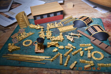

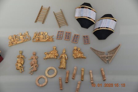

Well, the situation is still pretty much the same. I am about to finish Batavia these days so I will come back to De Crone very soon. In the mean time - as I am volunteering in the Sydney Maritime Museum - I made some carvings for it but they are not installed yet so there is no point to publish a picture about the model at the moment. Figure head (or heads because they are two) are nearly finished, gunport wreaths are done as are some of the side decos. Some pictures will follow soon.
János
This is great news, Janos. Please do not forget to show us what the finished Batavia looks like.

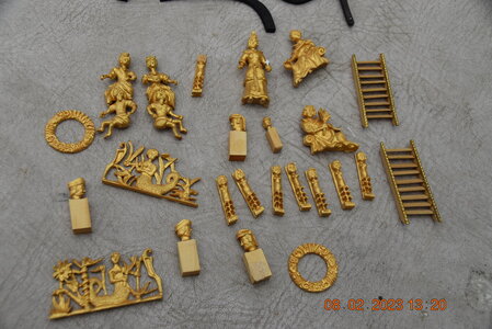

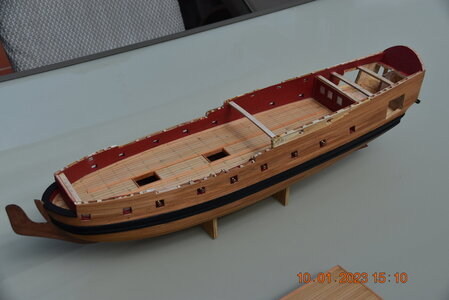

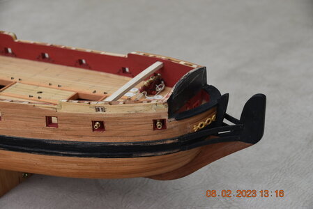

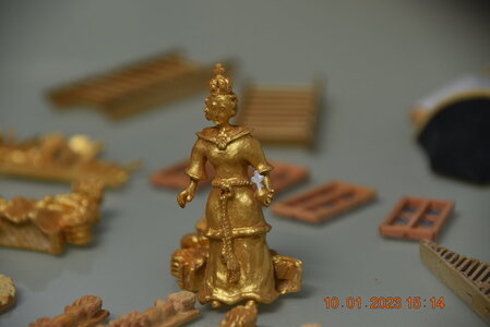

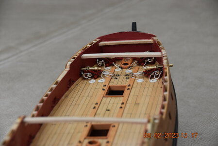

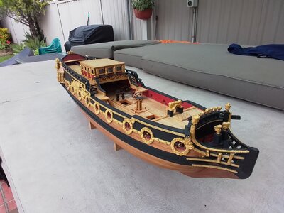

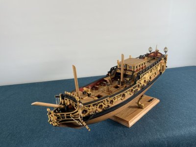

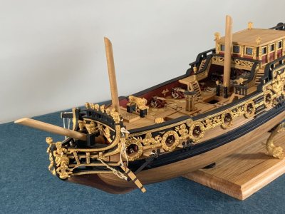

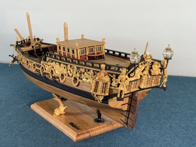

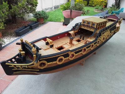

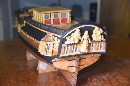

A few steps ahead and more steps back with my De Crone. This is the current state. I've got a few more carvings done but not installed yet (ie. figure head, pumps, more decos), they will be put on at the last minute.
I love your work - as I know you had a very good teacher
