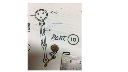

Working on the Bounty but having trouble connecting the chain links to the deadeye and channel plate. The chain links are quite fragile and easily break apart. The problem is the chain link joins at one end and so when connected to another link. It disconnects at the slightest pull. While in the diagram, it shows the link joins in the middle.. So once I assemble 2 links, should I apply glue at the joint or is there another technique ? I have over 24 to assemble.
Attached is a picture of the items.

I have seen this chain plate design in the accessory after market. I don't understand why they would not have made the join in the vertical side of the links, as illustrated in your plan. It would be much easier to work with and have a higher tensile strength as well, making it harder to pull apart under stress/load.
With that said, I have had success cleaning the joining ends. I had to attempt to file the ends flat to achieve a better surface to solder. I used silver solder paste, which contains its own flux. This made it easier for me. I over applied the solder and then hit it with a small open flame torch, with decent results. But honestly, I would NEVER do it again. As someone else mentioned, in the future I will just create my own. It would be about the same amount of work. I would not be cursing anyone. And, I would have a greater, proud feeling of accomplishment.
If I had the pieces you have, I would keep the deadeye strop and plate, discard the chain links. Pick up some hardened brass wire of the correct diameter and scratch make the links with the joins on the sides. Make sure you buy "hardened" brass wire, it makes a difference. You can make a simple jig from a block of wood with two nails or drill bits distanced to equal the length of your desired chain link. Then wrap your wire, cut, solder and blacken, rinse and repeat. I used to have photos of how I did this, but think I lost them when I upgraded my phone.
