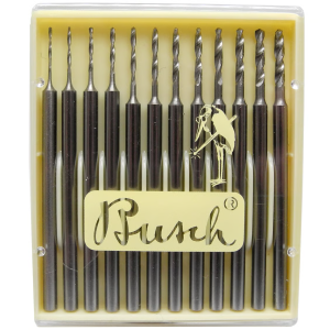

Busch drill bits are high-precision tools manufactured in Germany, renowned for their exceptional quality and consistency. While they are designed primarily for fine work in fields such as jewelry-making and dental technology, I found an excellent use of them in model building. These bits are especially valued for their sharpness, concentricity, and durability. They typically feature a standardized 2.35 mm shank, making them compatible with micromotors, rotary tools, and nail drills. Available in small diameters — often ranging from 0.5 mm to 2.3 mm, Busch drill bits are ideal for delicate, detailed drilling where accuracy is essential. While they are not cheap, their edge retention and overall longevity tend to outperform most counterparts. That said, due to their precision-ground tips and fine diameters, they can still break under stress, so it's hard to say they’ll last a lifetime. Still, with careful use, they offer a longer working life and sharper performance than many lower-cost alternatives.

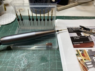

Rob, I don’t use the Arromax rotary tool myself, but I’m very happy with their drill bits. They come in two sets—Set A and Set B—and together they cover a range from 0.5mm to 2.3mm. Conveniently, they’re all on 2.35mm shanks, so they’ll fit perfectly in your current nail drill.
Set; A 0.6mm-2.2mm
set: B 0.5 mm- 2.3mm
I ordered a set of the Arromax drill bits. They only run about $18 for a set of 10 on Amazon. As Jim said they fit perfectly on my $10 nail drill and do a superb job when I tested them on some wood. I am really impressed of the value of both this and the nail drill. It is also so much lighter, more compact and easier to use then a Dremel type tool. The Dremel does have significantly more torque but for my purposes this setup seems exactly what I need.

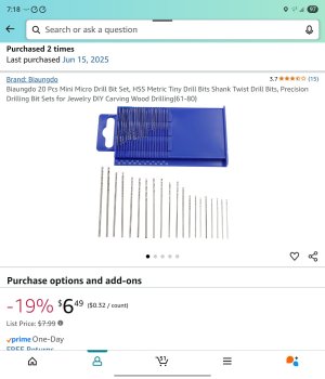

I have been using this drills for years and never have a problem. They don't brake, but can bend if you crash them against the workbench when they are mounted on the drill. Ask me how i know it :-).
I can't remember when I ordered my last set. Probably more than 5 years ago. Yesterday I searched them in Amazon and ordered 4 sets because they are the best ...... at least in my experience. I Used them with drills and milling tool, never a problem. Always sharp enough to drill wood.
FROM GOOGLE
Drill bits labeled with numbers #61 to #80 refer to a specific number gauge system used to designate very small drill bit diameters.
Meaning of #61 to #80:
  • Smallest sizes: In the number gauge system, higher numbers correspond to smaller drill bits.
  • Tiny holes: So, #61 to #80 drill bits are designed for drilling very small, fine holes in materials like wood, metals, plastics, or jewelry.
  • Size range: The set of #61-#80 drill bits typically ranges from approximately 0.0390 inches (or 0.991 mm) for size #61 down to 0.0135 inches (or 0.343 mm) for size #80.
In summary, drill bits labeled #61 to #80 indicate a range of extremely small diameters, where #61 is the largest and #80 is the smallest, used for precision drilling of miniature holes.
