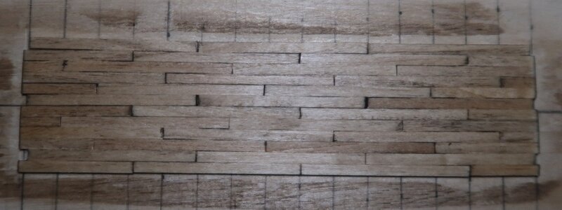

I'm working on my first kit, the Modelers Shipyard Colonial Schooner.
I messed up the deck planking to the point where I ripped out the planking and ordered replacements. While waiting on the replacement material to arrive, I spent some time practicing with the silver ash I had left in the kit, plus some basswood strips I had on hand.
The attached pic is basswood strips and while my photography skills are down around my modeling skills, I hope you can make out the different shades of the wood. Some of the planks are a bit darker than others. The difference is even more pronounced with the silver ash.
So my question is basically is there a material suitable for deck planking that's doesn't vary so widely in the shades of the wood, or, and this may be more to the point, am I just overthinking things again.
FWIW, I'm thinking about going with the basswood instead of the silver ash since the difference with the basswood isn't as stark as the silver ash. The differences with the silver ash does make for an interesting visual effect, but it's not what I'm looking for on this model. I'm trying to go with a more "weathered' look on this rather than a museum piece as "weathered" makes it easier to hide my mistakes. :)
Thanks in advance. Hope all are doing well.
Charles
there are several types of wood that do not very in figure or color and some place on the forum there are topics covering the subject of decking, wood and finish but i could not find them to add a link.
Thanks Dave;
I ordered more basswood strips from Micro Mark the other day. When they get here, I'll sort through them and see if I can come up with enough timbers close in color to do the deck.
If there's not enough to do that, then I'll just make do with what I've got.
I suspect by the time I'm done with this, mixed shades of deck planking is going to be the least of my problems.
Charles

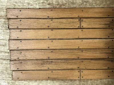

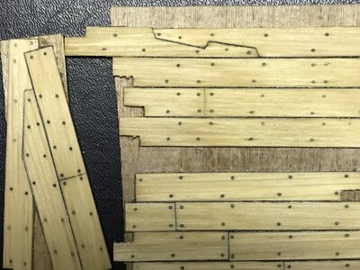

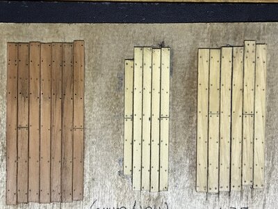

I am quite surprised you didn't have so many answers. Personally, I would instantly think about Pearwood (natural) and boxwood, but maple and holy could be a good alternative. Lately, I played with hornbeam as timber for the deck and was very satisfied with how it came out under oil.
Here is an example of Hornbeam
here is pear
here is Holy
here is pear
here is Holy
