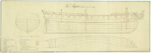

Also, any Spanish ship captured by the British will have had exquisitely detailed plans taken off of it, and the Admiralty seems to have kept all their paperwork. You can't get more accurate than a set of as-builts.
I took a look at:
andfound theat the HMS Amfitrite, AKA HMS Blanche was built by Spain. It is a well known ship, so there should be some details out there.
These are the docs of the HMS Blanche at the RMG:
Scale: 1:72? (graduated bar scale). A plan showing the body plan, sheer lines with inboard detail and figurehead, and longitudinal half-breadth for 'Amphitrite' (1804), a captured Spanish Frigate, prior to fitting as a 38-gun Fifth Rate Frigate. Note that this is a Spanish plan, showing the vessel under her Spanish name of 'Anfitrite' (1797). The vessel was later re-named 'Blanche' (1805) by Admiralty Order dated 3 December 1805.
