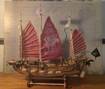

My Chinese Junk build is almost complete, and I'm shopping for display bases.
It seems like there are generally two philosophies - wide (about 120% hull length) or narrow (about 70% hull length). And maybe there's a hybrid approach, where people do both, the narrow on top of the wide.
Are there traditional standards with display bases? My build is a little on the elaborate side. I took a lot of liberties beyond Amati's very basic kit. So I want to balance this with a conservative display.
My tip-to-tip (not including the aft flag) my ship is 15".
20250511_203940.jpgI was thinking of cherry wood with a light bevel and scalloped corners.

I am confused by your measurements. A base with a 120% width of the hull would be huge, even 70%. The length of the base does not have to be the full length of the model. Some smaller models look very respectable on a shorten base. Concerning the width of your base board, I would suggest you take that cutting mat in the background, lay it flat and place your model centered on it. Next stand above it and look down to determine what would be a good width for the base. Imagine you are placing the model in a plexiglass case, how much clearance would be appropriate. Just a suggestion.

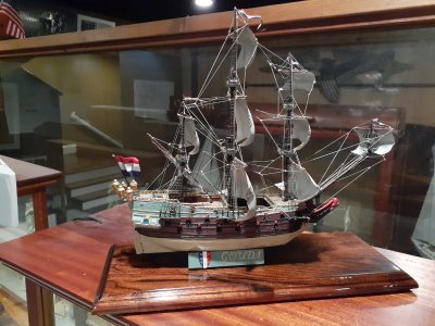

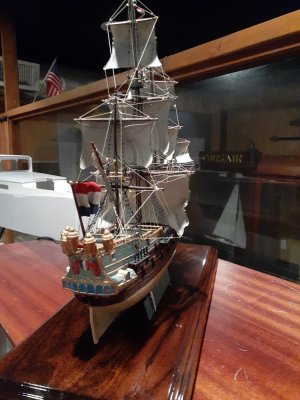

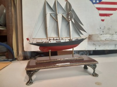

This one is glass.

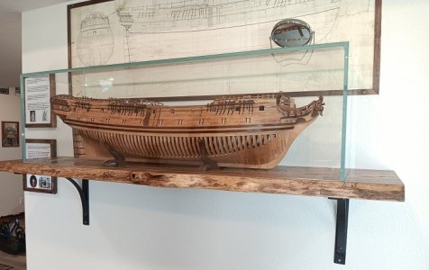

This one for a cross section of Bonhomme Richard is plexiglass (much cheaper and lighter).

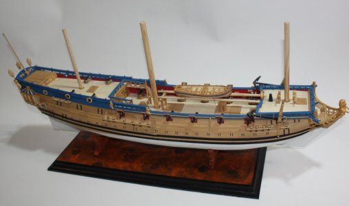

The base can be a simple piece of wood or something a little fanciful like a burl finish which is really easy to make on a piece of plywood or MDF.

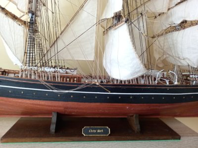

My display bases are generally of the form shown below. The supports are cut and shaped to provide a good fit to the hull. I always use long, thin brass screws to screw though the base and into the keel so that I can pick up the model either by the base or the hull without them parting company. The width is a bit arbitrary but usually a bit more than the hull width. Ship models have a fairly low centre of gravity so stability is rarely a problem. I have never used the flimsy, plywood bases provided by kit manufacturers.Display Base.jpg

Great looking build. How did you get the dragon image on the sail?

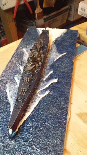

When you have the case dimension, then you can consider how best to provide a mount for the ship. Something that looks like water? A 'shipyard' scene with blocks and props, or a museum scene with minimal (brass) pillars into the keel (as long as the keel will take the strain)
