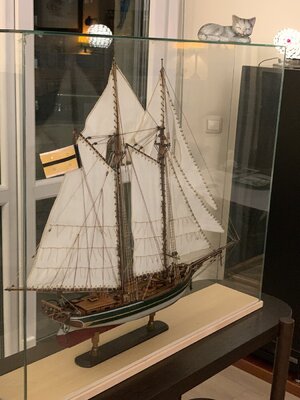

If you have the possibility to place the case in front of a natural light source e.g in front of a window so al transparent case is better . A black or dark colored back can always be added if you place in front of a wall.A mirror at the back or on the ground can also disturb .Mine in the attachment is made of 4 mm thick tempered glass with spaces 4 to 6 mm .If you chose glass it is heavier than plexi but not that sensitive to scratches
