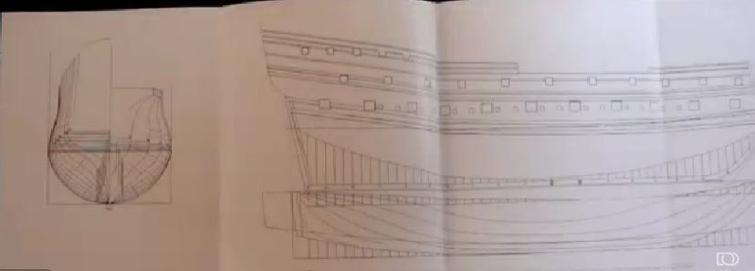

I have in mind drawing each individual frame for HMS Lenox. Based on great book by Richard Endsor - "The Restoration Warship". Great publication, which I bought years ago in Portsmouth Dockyards.
Anyway, plans included in the book are great but what I am missing are waterlines. I have station lines, side plan, but no waterlines.
Station lines show around 20 bulkheads, which is mor that enouch for POB.
I would like to draw all the frames in between, let's say 40 or 50 depending on the hull.
As I said, I do not have waterlines drawing. How can I start here? Old way with pencil and paper - no CAD.
Has anyone done that?

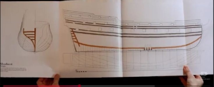

there are waterlines in the book

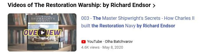

i might have the wrong book by Richard Endsor the title is not what the video shows there are 2 different books

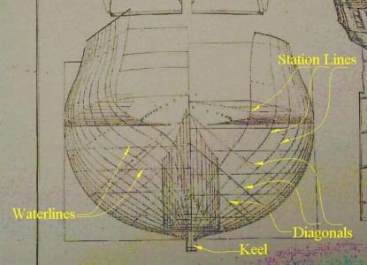

Waterlines are not particularly relevant to achieving your primary goal of multiplying the frames. Diagonals are much better for this purpose, as they yield a better, more even distribution of coordination points along the length of the frame contours, and being bent only in one direction are easier to form than waterlines. In fact, waterlines normally only serve a verification function, unless you also want to calculate (manually) the volume of the hull.
In addition to the diagonals that are on the base drawing (if there are any at all), you can also add as many more diagonals as you want, based on the contours of the existing frames. Overall, this is a trivially easy and fairly reliable method without resorting to old design methods, but quite tedious for such a large number of frames.
All other things, such as the type of paper and brand of pencil, are up to you, but I would advise you to stay focused on this task, because any inaccuracy or shortcut can come back to haunt you many times over and in a painful way. Besides, by following this procedure, you also have a chance to verify the accuracy of your base plan.
