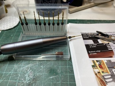

I have been using a nail drill that I picked up from Amazon for $13. It is much lighter weight and easier to control than a Dremel. The shafts are not the same size but arrowmax drills fit it. I use it mostly for sanding and drilling holes. It does not have as much torque as a Dremel but it is more than enough for my needs. I highly recommend it for use on model building.

It certainly has many more accessories like buffing pads cutting disks to use and I have a Dremel. I just find it too bulky in my hands to use well especially with delicate model parts. I find the nail drill really useful, compact and I use it almost daily. It is set up on my bench, the Dremel is stored away, Plus the nail drill is much less expensive. the Arrowmax drills are a great value and are well made. They come in 2 sets of various sizes.

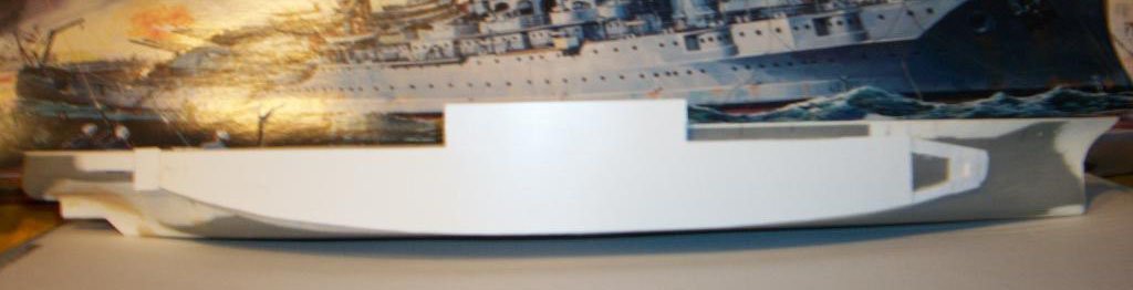

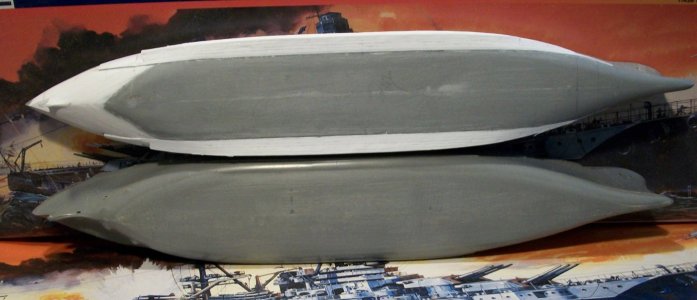

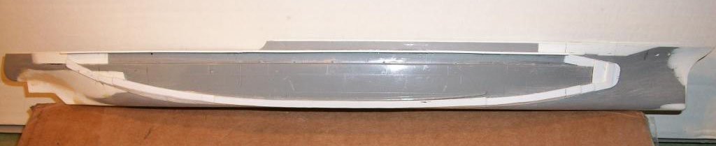

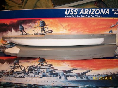

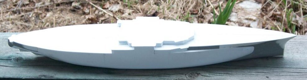

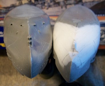

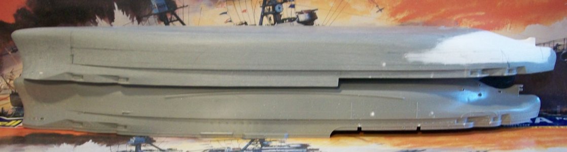

i use the older Dremel tool on my OBB build of 17 models using Revell's 11/429 scale model of the USS Arizona as a basis to correct the concave stern, fix the shape of the torpedo blisters & do clipper bows & combination clipper & ram bows.
