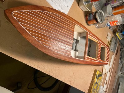

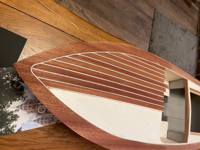

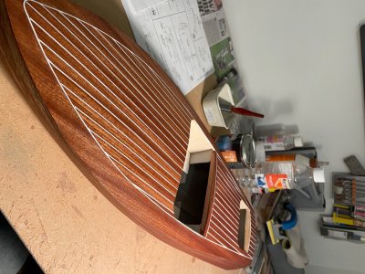

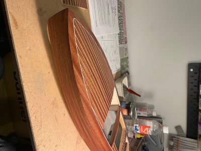

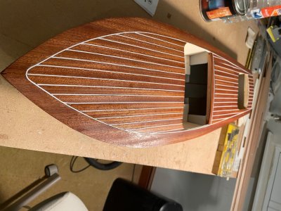

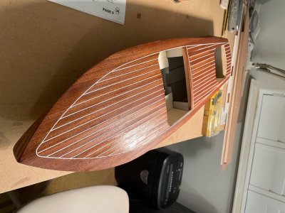

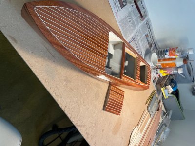

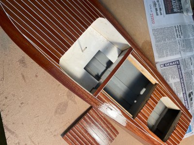

Dumas #1249 Racing Run About.
Time and patience… considering I am new to this, I think I’m doing OK… so far…
That is one superb model, illustrating the precision and prettiness inherent in the planking. Very well done.
If I may make a suggestion, it looks as if your varnish is showing a slight orange peel effect which could be the grain texture telegraphing through. To remove it requires careful rubbing back using 400 grit, then maybe 600. Thin the varnish and use a quality brush to apply further coats, allowing 24 hours between coats. If your finish has sufficient body you could move to a wet abrasive for the final stages.
If you look around for finishing systems for car paints, there is plenty of explanation. Be good to have a glass like finish just as on the original.
Jim
Thank you very much Jim.
Appreciate your comments and advice.
I have given it a very gentle rub down and another coat. Yes it is the grain of the mahogany coming through I think…
I think I might leave it at this now.
For me, completely new to this type of finish and detail, I don’t want to overdo it and mess it up!

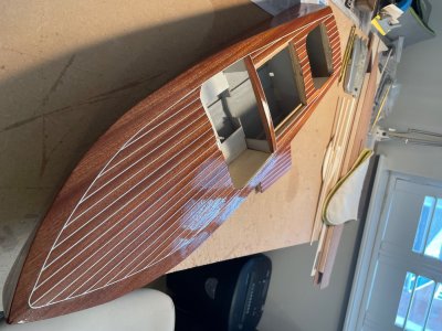

Here are the pictures of what she looks like now…
Regards,
Namery.
That’s good.
Next time around then. It was a good while in my day job apprenticeship years before the need to do things like grain filling before applying finishes, and taking care to de+nib on every coat and thinning lacquers , and French polishing and making up dust excluding tents, and top coating in the morning when the airborne dust has settled, and.. and…
Enjoy!
J

Hi J!
I have got some 600 grit paper and have taken your advice so thank you!
I’ve given her a gentle rub down and a further coat.
Have to say it really has made her come up again so thank you!
You really know your stuff and it looks like you have a wealth of valuable experience. So the fact that you took the time to reply and pass on some of your advice is much appreciated.
‘Till the next one!
N.

You're right, slow & steady is critical. but if I can save save time without negative results, I'll take it. (On my Victory, I cut out the gunports with a Dremel sircular saw, saved so much time!). Funny, back when I was first painting cars, I was shocked when told to sand my nice, glossy clear coat!
It's been some 25 years since I built these, need some repair now, grandkids would run amok down in the recreation room. Been meaning to get them done when I can get time, and take some pictures (or I could show them as the rug rats left them).
Seeing what you've done so far, she'll come out great!
Niiiice! When I built that I remember my disappointment with their castings. Haven’t done a model of theirs yet that had decent castings. In fact usually horrible. You may consider…. When I complained about the “chromed fittings” they sent me another set without the chroming done. That allowed me to buff the parts bright and shiny followed by clearcoat. They looked way better. Also, there are a couple of castings for “step plates “ where people would step to board the boat. A big improvement over the castings was a piece of thin black plastic (mine had a slight texture to it) with Bare Metal Foil folded over the edges to replicate the metal trim. Way more to scale and realistic looking. Another good one was using a rotary tool with micro milling bits to hollow out between the spokes on the banjo steering wheel by hand. I think I broke a dozen of those bits doing it but the result was awesome. I have bunches of pictures of the finished boat if you want to see anything in particular. Just let me know.
Nice job there on that finish. I’d just recommend a final coat of UV protection varnish or whatever to preserve that shine without yellowing. I have done a few, of Dumas boats. Never a Chris Craft though. I always wanted to get better at finishing before taking the plunge. You learn a lot actually because some instructions are simple and you have to figure it out. Good work and keep it special. Dumas is out of business. I’m got miss them.
