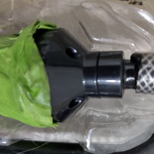

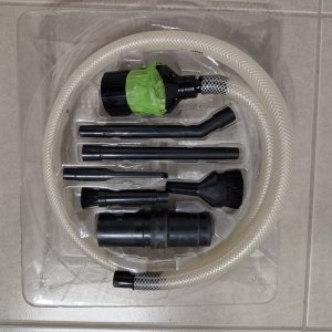

I bought this set of vaccum attatchments from a (now defunct) specialist shop in Australia which sold vaccum cleaners. In the second picture it shows the end which attaches to your vaccum cleaner and it can be rotated to ajust the amount of suction/airflow. (the green tape is so it doesnt change the setting while in use). It is very gentle and as you can see there are numerous attachments to get into the smallest of most places. I only have to remove all the tiniest non attached objects from my ships boats before use, ie water barrels, lanters etc . I have never had a problem damaging any part of my ships or boats wood work sails or rigging. It is far more effective than blowing the dust around with those bulb thingies.
Its still a pain cleaning the objects and is only undertaken when my ncommander notices an accumulation.

I was just about to go take a pic of the same system I have-it works really well. I have a two ended vacuum that can either suck or blow. This gear and a few long brushes usually do the job.

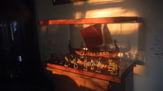

I make cases for all my models. I use acrylic sheet. Use thin sheet, or the case for a large fully rigged model will be very heavy. Acrylic solvent or cyano instant glue works. Four short vertices dowels just inside the corners keeps the plastic in place on the base. I cut the sides and top on my table saw.

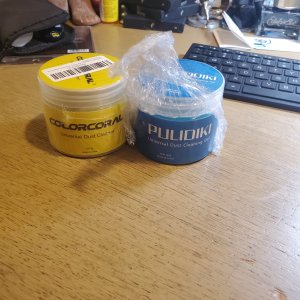

I find these products work very well as a goo dust magnet that is soft gentle, works nicely into crevices and pulls off without leaving residue (counterintuitive when you first use it.) Relatively inexpensive and gobs of it are reusible quite a few times so goes a long way. Good on wood decls and deck furniture etc. as is easy to get into crevices. Requires finesse and patience as hamfistedness never works well with any method.

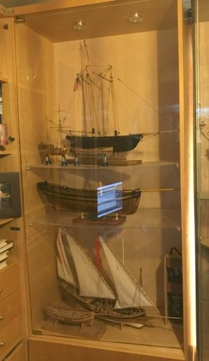

The glass in my glass cases fits into saw cut grooves in wooden framing. I do not glue or otherwise attempt to seal into the grooves. I also make no attempt to ventilate the cases. Air leakage around the glass is sufficient and I have had no problem with dust in a house with forced air HVAC.

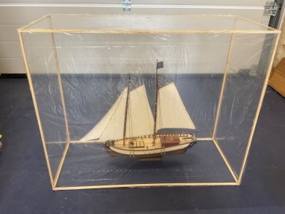

Based on all the suggestions I decided to buy some thin wood strips and make it into a frame and cover it with the plastic bags you get your clothes in when you take them to the cleaners. The cost was cheap, £8 for the wood and similar for the plastic bags which was cut to fit as you can see.
Nobody sees the models except me as they are in my garage / workshop.

I love this solution. Model is safe from dust.
