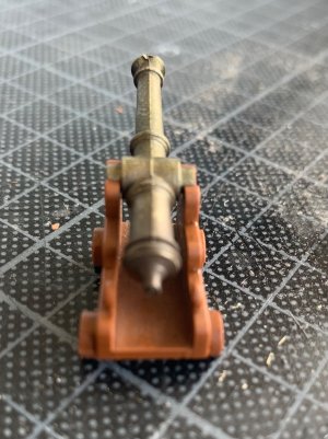

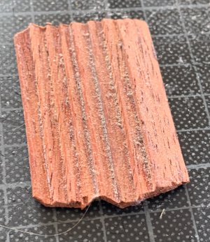

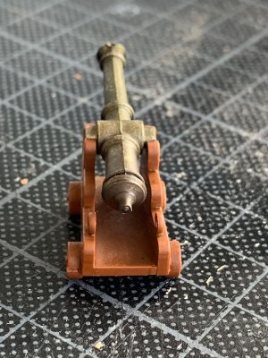

Blowing,Brushing with a soft brush or Spraying the solid parts with a diluted transparent varnish

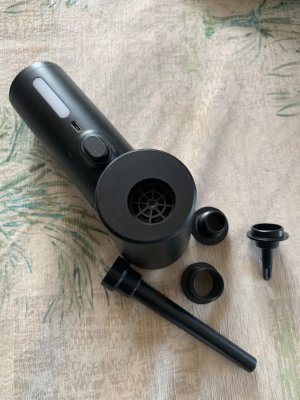

İn the attachment
my blower is rechargeble and 2 step blowing grade

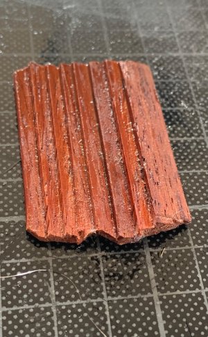

Varnish treated part with extra dust on it before&after, refreshes the dull appearence also.Test this method before appliying on a small area.İmportant ,do not apply on the ropes and sails
