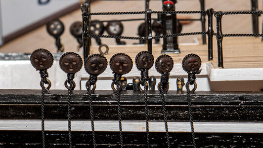

Hi Guys and Ladies of SOS. I would like to paint/dye my many dead eyes on the Victory Model black. I have painted one with Indian ink and it is good. Question: can I just soak them all in Indian ink or must I paint each individually?

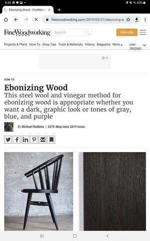

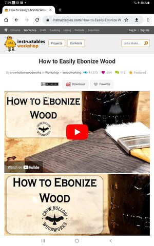

Another overlooked method is ebonizing wood to darken it. It involves vinegar and steel wool....
Hi Phil! do you have any more detailed info about that process? I've been working on an old wooden stool that's been in my family for decades and that finish from the photo looks great.
Always use a test piece when using the vinegar/iron stain. Because it depends on the amount of tannins in the wood the results can go from jet black(like you might well use paint) or no effect at all. Personal experience here.
