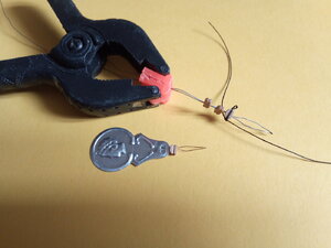

Fuse wire makes a good equivalent threader for situations where the item cannot be passed through a needle threader.
(E.g. on a bight, loop, of link of a chain). Double the wire round the cord or thread it through the end link of a chain.
Thread both free ends of the wire through the hole and pull.

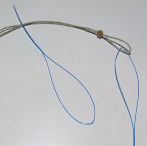

Block threading
The picture below shows a series of blocks threaded on a doubled length of fuse wire.
While thus restrained it is easy to tie on the strops - with or without a tail loop. (Production line processing!)
The blocks may be removed one-by-one after passing the relevant piece of running rigging through the loop in the wire.
Double blocks may need to be revisited with a needle threader.
The blocks shown are 3mm. The larger ones are even easier to process.
