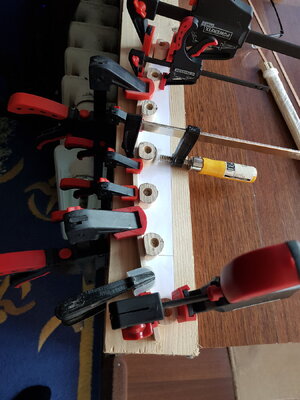

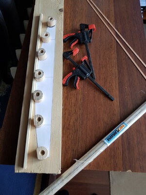

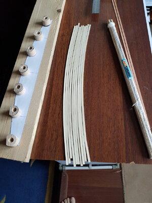

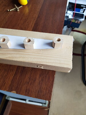

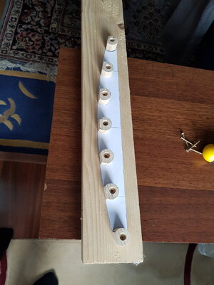

Edge bending is an entirely different thing and heated bending irons do not work as well for this. Edge bending is a must to prevent lifting at the bows when planking. Actually, the amount of curve varies a bit so I use different shapes every few strakes, but I can see how the device above can be made to be adjustable. For more on edge bending take a look at the four part video.
Badras Kahn, would it be easier to taper the breadth of the planks before shaping the bend? Thanks for sharing your design. Next up - will you design an adjustable unit?? :)
While limited "edge setting" can be accomplished with narrow strip wood, assuming the wood species is amenable to bending, which many aren't, it is not the best practice to do so other than when the bend is very slight. Essentially, edge setting is "torturing" the wood. The far better practice is to spile and cut planks to the exact size required. Planking that must curve to follow the shape of the hull, running parallel to the centerline, is perfectly acceptable, but edge setting is a short cut that often is more of a fool's errand than anything else. Some kit manufacturers advocate edge setting (especially in models that are intended to be finished bright, rather than painted) because it permits them to supply narrower strip stock in their kits, thereby saving production costs. This is to be expected, perhaps, but more often than not edge setting strip stock without proper spiling and shaping of the plank results in planking seams which do not run as they would have in real life and result in only an approximate depiction of a planked hull, rather than an actually accurate miniature representation of one.

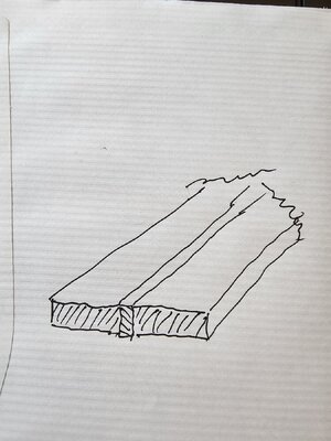

A technique I have seen described (but have not tried for myself) is to plane your stock down to the same thickness as the width of plank you want to bend (i.e.: if you want 1/4" wide planks, plane your stock to 1/4" thickness). Using your preferred traditional bending technique, bend the stock to the shape you want your finished plank to have, then simply rip off a strip of the desired thickness.
I hope that brief description makes sense.
