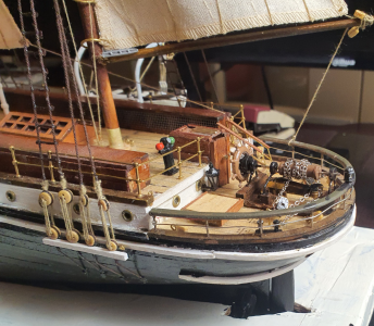

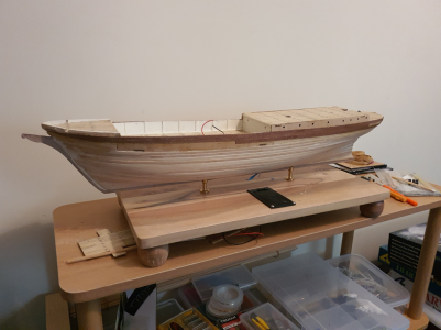

The Question relates to the position of the deadeyes for the front Mast, As we seem to agree they were on a side board and not the rail. I have based my assessment on an old model because I could not find any detailed photos
The stairs that come with the kit are not great. I note that some builders chose to make their own out of wood & this allowed them to install hand rails. I tried to move someway towards this by using the kit brass stairs but adding wood side pannels so that I could install hand rails. THEN :---- I discovered some stairs on ALIexpress at almost the right scale that included side rails. Cheap and not bad. I am quite impressed with them & will use them in lieu of the kit stairs

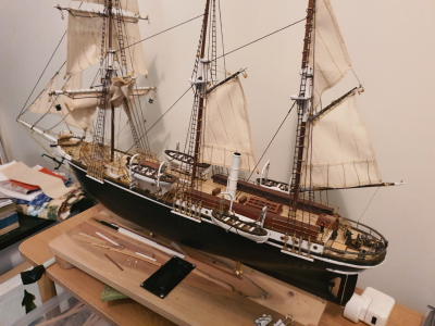

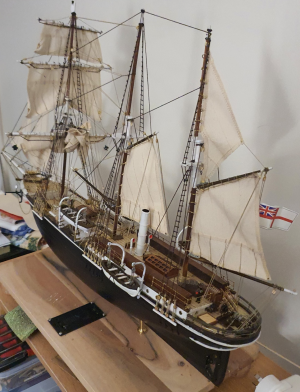

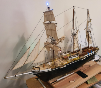

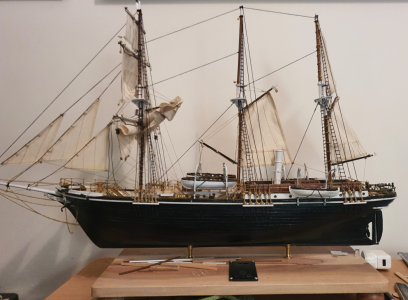

When you get to my age, you have to be careful. whilst installing the main rigging with deadeyes I moved the main sail too much and broke the connection of the main spar to the main mast. I realize now that I should have made this stonger in the first place. I also broke the connection to the spar lights, This was fiddley and lengthy but it is now up and operating again with a strengenthed flexible connection between the main spar and the mast. Lights reconnected but some tidy up work to do.

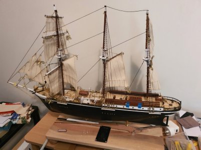

Just a little more every night. This is going to take some time for the rigging which is complicated & FIDDLEY

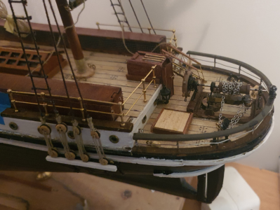

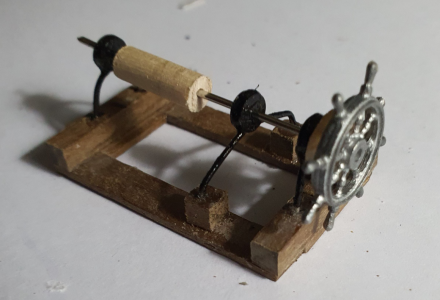

I have reinstalled the steering mechanism with quite a few small modifications. It works but I must admit I sprayed the Chain with CRC. Still I am pleased that it works. Tried a smaller chain but as they get smaller the fexibility decreases so I think what I have got is a happy medium

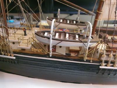

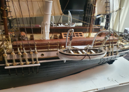

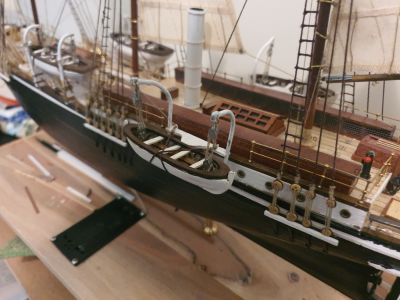

All the lifeboats now in place. I drew a lot of info from others on this site whilst installing these boats. I will say I am not quite at 100% approval of the work at this stage so I will think some more. Meantime still a lot to do about all the othe items

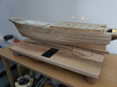

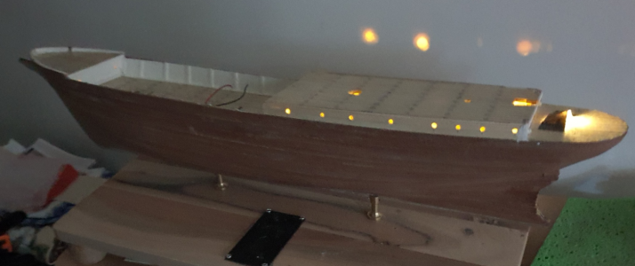

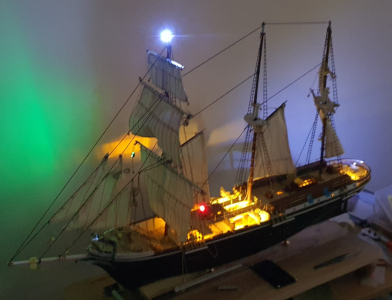

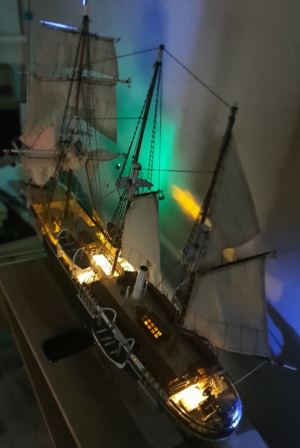

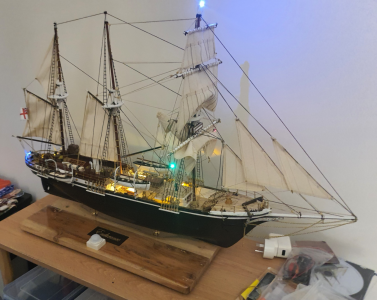

A bit of cargo struen over the decks and the rigging finished. I just have to complete the electrics. I want to install a sensor in the base so the when a presence is detected the ships lights will come on for 30 seconds
View attachment Finished Vid.mp4

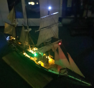

Just about completed the Base for the Endurance. This base supplies the power to the lights (2 x AA batteries at 3 volt). this power source feeds through a sensor that trurns on the power when you approach with 4 meters. if you leave, the power will turn off after 30 seconds. I am quite happy with the result as the ship will be sent to my Grandson (some 3500 km away) he will think this is magic - well maybe not. Kids are not supprised by technology these days. The sensor and Battery holder cost less than AU$12.00 from China
