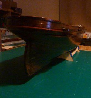

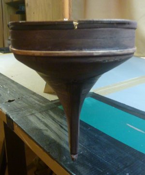

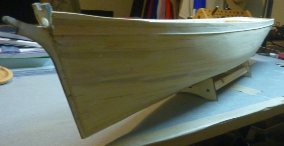

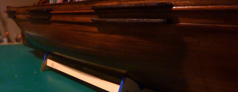

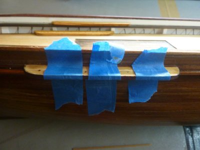

I have 'almost' built the Cutty Sark twice in the past. on my third and current effort I decided to dispense with convention and alter the design to include, adopt and resemble notable/aesthetically pleasing aspects of other 19th century clippers. As an ex-army rather than naval veteran I have little credibility to lose, and my admiral is merely seeking an antique-like artifact to fit our decor. So, onward and upward with the as yet unnamed vessel. Not a scratch build by any measure, but perhaps an excessive kit-bash. My vocabulary is improving. Good fortune with your adventure - it is great fun.

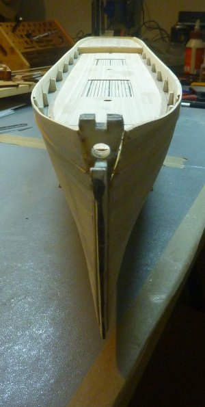

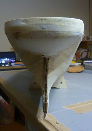

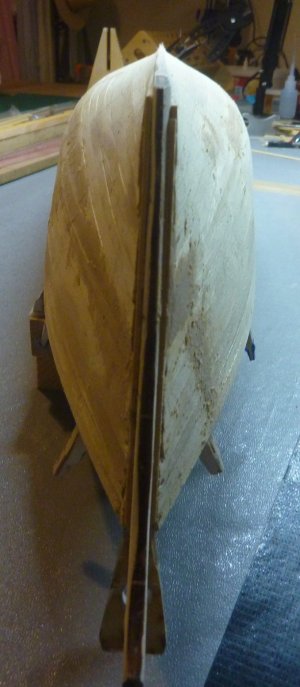

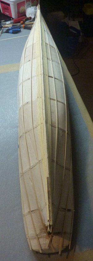

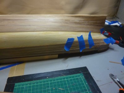

Some of the progress to date after double planking with walnut. The current effort focused on external rigging rails after the Thermopylae. These rails are fixed with brass rods drilled through into the balsa hull filling.

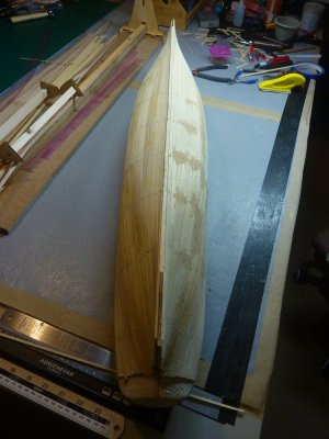

Frame

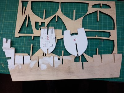

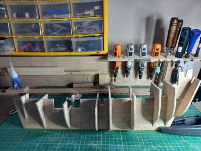

Bulkheads 2 – 5 have been drawn on a sheet of 4mm birch ply using the Remains of the AL Cutty Sark bulkhead sheet as a template. The OcCre pdf instructions for HMS Revenge were expanded by 335% to display the image of the bulkhead sheet at the same scale as the physical sheet supplied with the kit. A screen capture and print provided paper templates for bulkheads 6 – 10. A similar process was used to mark out the false keel. A long session with a scroll saw produced the frame shown below as a dry assembly. Bulkheads 5 and 6 were modified slightly to smooth the transition from clipper to galleon.
