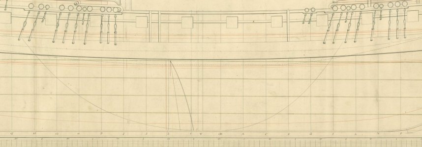

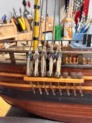

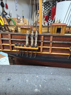

All the chain plates look to be vertical in the photo above. I am not familiar with whalers, thus my question, were whalers different than other ships where the chain plates were in line with the shrouds?
Thanks

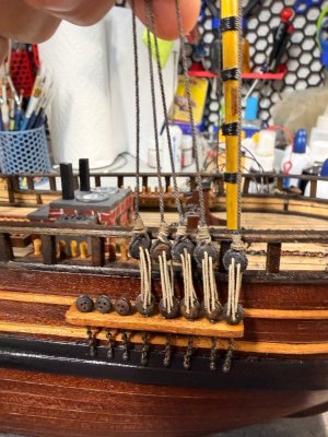

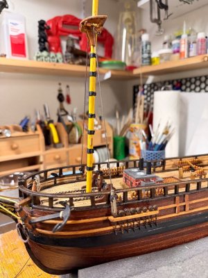

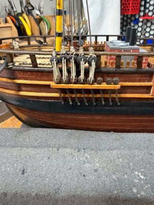

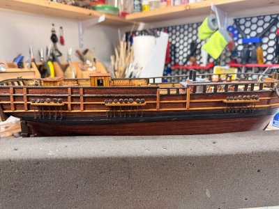

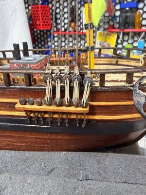

Top picture is the port side. Lower picture is the starboard side. After tying 26 deadeyes I can see the last ones look a lot neater than the first ones. After all that effort I decided to re-do the first on the foremast.
