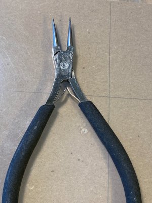

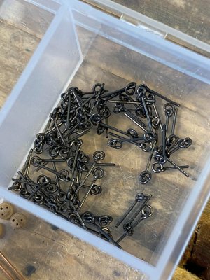

These pins are so easy to make by yourself. Why should one buy them? I make as many and of any size I need in minutes. Here is an example and even with iron rings installed. I use round nose pliers. I recall @Jimsky had wonderful tutorial on this topic.

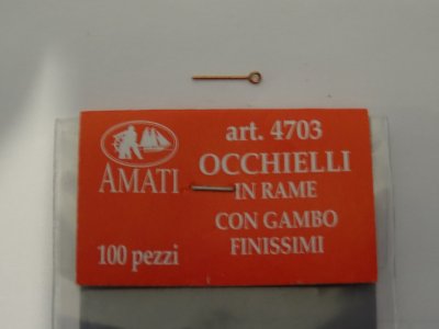

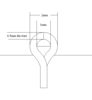

I am hopeful someone can help me find an eye pin that is made of 0.5mm diameter wire with a 2.0mm OUTSIDE diameter eye? I've looked and I am unable locate any. Plus there doesn't seem to be a uniformed way of describing the sizes on various websites and that makes it more difficult. HELP please.
1. Pound a nail into a block of wood and bend the wire around the nail with pliers.
2. Buy the needed size wire/nail or reduce the size of a larger diameter wire/nail.
3. It is easy to make hundreds of eyes in an hour.
