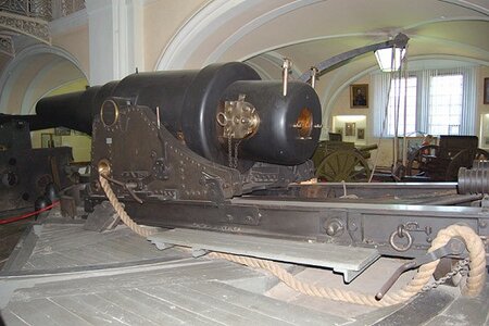

11" Krupp model/Obukhov manufactured Coast artillery gun in the 1867 model (the 1877 model differs in barrel detail and mainly in carriage).
{Source: Wikipedia}
Some of these are still standing in the fortifications Helsinki/Finland.
{Source: alternativhistory.ru}

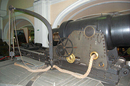

"She" is a really beautifull pice of engeneeing and worth showing a bit more of her detailling (here the 1867 model).
In this colourful appearnace with the copper barrel inside the brass sliding block the black barrel and the brownish carriage standing at679398_original.jpg
St.Petersburg naval museum. I do think to "show" her by a top view in the turret's opening. This will be protected by a grit or a better protecting lamella roof opening for the smoke - not to her to become a barbette ship suddenly. ;)
{Source: navalmuseum.ru)
For the idea of the size of the 11inch gun here a helpful picture of the coast artillery crew at work.

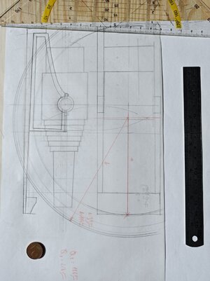

So here ist the 1/32 drawings with my 1/64 scale figure - even doubling this guy shows an impressive barrel to us. 10800mm in length, 2880mm max.diameter will give a a appx.3500mm breadth for the carriage and sliding hill INSIDE the turret. So the turret's inner diameter must be more than 10m as a gun usually recoils (also breaked) it's barrel's length. So the turrets structure the thickness of the armour add to some 12m of diameter. So any turret ist a Monstrum on its self and due to this ideas only a single gun per turret seems to be possible as if we packe two guns in one turret we do get an 7,5m inner radius.
In the next days I will go to the copy shop diminishing the drawings towards 1/64 and 1/128 (die to my new smaller flat I will be forced into this scale) to "play" with my paper cut-outs on the drawing board to look what is going in. I have to admit this is really fun to deal with.

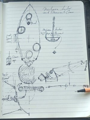

- mushrom anchors for permanent mooring
- torpedo nettings to avoid spear and early fish torpedo to enter the hull - even while slowly moving
- Something like a barriage floating with a phalanx of spikes (to sink incoming vessels?)

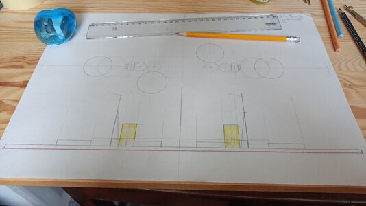

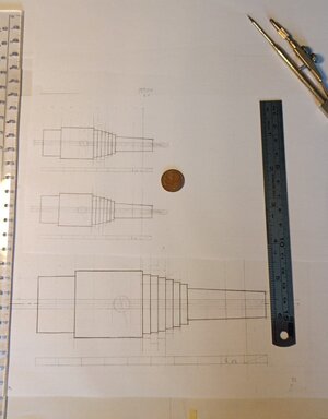

SCALED TO 1/128 & 1/64
So being back from the copyshop we do get a nice view onto the recuced scale output here:
recuced to 1/64 and (twice) 1/128 scale. The barrels do fit my expectations - also the muzzel is very thick by three times the caliber.
And you do hopefully also do get a good idea of the enormous size of the 15inch RBL* gun barrel even without it's carriage, the coaxial zero-firing rifle for sing purposes and all the other fancy stuff to be added. If I do find some time this week end I would like to computer out the pure wright of the barrel estimating the material as early Siemens-Martin-steel (as it was used from 1864 onwards).
Next step will first be figuring out where the hell I did store my frostpaper to draw the carriage and the "slideing hill" rails and than starting with the next layer of frostpaper for the enormous turret structure and it's heavy multi-components armour.
Hopefully the metric and imperial gauged ruler is helpfull to you (I found him but not the frostpaper till now).
As you could recognize the lower and upper part aren't mirrowed but slightly differ and I am not shure what part will be the used one.
I am thinking about a kind of prototype turret in 2:1 (1/64 ) and copying the drawings down to 1/128 so I do get a reasonable idea what the inner layout of the turret must be like ergonomicaly (ladder, paths between inner wall and gun and in the other hand due to the guns elevation, recoil and the neccesary of safe ammo-handling. (I do think about an ammo lift in kind of a dumbwaiter to avoid the pileing of explosives in the turret {so a short light railway between lift door and breech hast to be estabished} not very unlike to be found in the decks of torpedoboats).
And again I used this article as my idea storage, too. So if there is anything you do think doesn't fit into an 1869/70 construction pleased let ne know if I do get too much in a Jules Verne's path of thinking.
Thanks a lot for your support and interest.

Such a sunny day and a small step foreward to the turrets' construction. The inner and outside diameter is now calculated for the "development turret" in 2/1 or 1/64 instead of 1/128 as scale:
So it is inner diameter 186mm or 7-1/3"
and the turret's armour has got a diameter of
228mm or 8-31/32".
Making the composit armour an astonishing 2.688mm or 8'3" thickto prevent the guns from enemy site at all Costa in the Dardanelles and opposing any French or British caliber during the next 10-15 years.

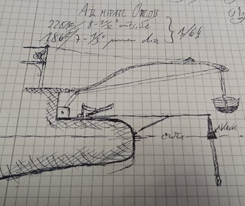

This the drawing how I got there - forgotten to take proper pictures of the process. Sorry for this!

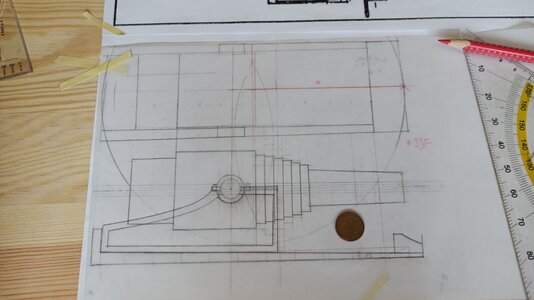

So the 1/64 measurements recently... Half of this die to the buildings scale of 1/128 will change my hole calculations.
So let's have a look what is happening dealing with four 228mm disks of cardboard in the basic lines. Then I have to cut out the pair of conning towers, stanchions for the gangways and davits, the ladders or stairs downwards, the two smokestacks, lots of vents to the boilerroom and last but not least the three masts. (And for shure something I did forgot about!) So a huge numbers of obsticals has urgendly not to be placed in the arc of fire of my four disks. But this ist next weeks chapter...
Here today's result on the frostpaper in detail:
I.
The turret roof needs to have a hinged hatch for fireing by max. elevation.
II.
Keeping shells and cartiges sepetated in two lifts with sepetated ammo bunkers below the turret.
III.
So the gun could be loaded faster by ready stored ammo in the side bunker using a heavy iron sliding door and a thinner roof.
IV.
And loaded from both sides makes the loading procedure even faster by one Bridges crane with a pair of independent trolleys for shell and cartige powder packeges.

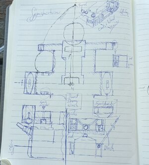

Stored my memorys in my notebook in the moment I do have got them is a very helpfull thing when you do get older.

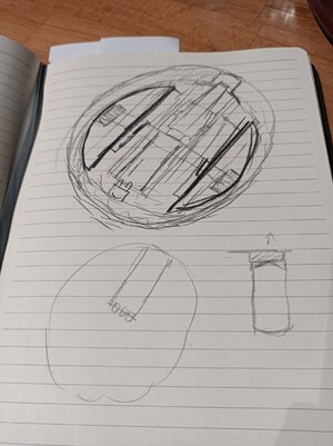

Today I did deal with the turret's detailing and the solution for superelevation of the 380mm gun.
I Also decided to get the turret's mostly autonomous by a day and nicht semaphore with wheeled petroleum lamps inside - so the lamps did stand upright all the time in any elevation.
The conning tower of each gun will have it's rangefinder and a" Glacis de Ricochette" is installed. I do also do deal with hammock baskets surrounding the turret's armour:
So here is my simple collection of doodleings to bundle these ideas onto paper.

Here a better scetch of the turret and the anchors' arangement:IMG_20220703_181355_699.jpg
All in all a 1/4of the construction must be enough as the rest is a mirrowed reenactment of this part.
Further progress will be made soon. And all these changes do necessitate further alterations onto the superstructure, too...
And my very next problem are these FISH TORPEDO CATCHERS
Was in 1869 steel rope avaible or do I have to weave out with cast iron rods (as these were only rusty in the surface)?
The frames are swimming by an attached cork part as a swimmer on the upper bar and need to be as long as draft.
And die to the task of permanently mooring at one place as floating frotress there need to be some
MUSHROOM ANCHORs
There is in the one hand the need to be set my two cranes and the setting hast also the handling by a diver for the secured placement. On the other hand are the Arcs of Fire to be kept as free as possible. So there is a lot of construction work to be done.
And last but not least the superstructure (here shown in blue) doodleings:
The upper part is showing a perspectivial scetch the lower left corner giving an idea of the Great Launch's mechanism above the next gun
and on the right side the small winch steam engines to Deal with the heavy wight of the Great Launch. They should be symetrical to get a pair for each Side - including a "Spark Avoider" to safe the sun roof canvas from any danger getting burnt by the funnel's output.
