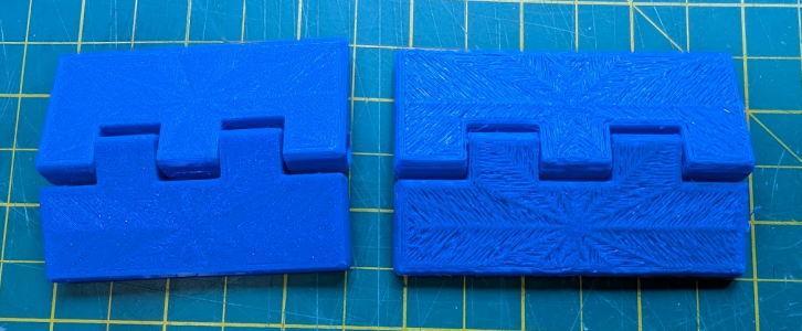

On to the illustration. This is a quick'n'dirty tool I needed and I figured on using up the leftovers of a roll of PLA than has been sitting around for months if not years. It's sliced for a quick print, I didn't need a fine finish. I didn't dry it out first, largely to see whether storing part-used reels in an airing cupboard does anything useful. It doesn't. So, on the right, un-dried filament, on the left, the same after about an hour of pre-drying.
In my opinion, this example does not seem to be a moisture problem. Rather, it seems to be a settings problem. But that doesn't change the fact that moisture causes a lot of strange errors and prints with all kinds of imperfections.

Sorry but I beg to differ! The only difference between the two prints is that I dried the filament for the second print. Everything else was identical.
I see 2 different parts (length), so you don't use the same gcode, there could be a different setting when you slice it. And if the top where you look at is the part that is on the plate (the first layer) you have to check your z-offset. And if you don't have an autoleveling you have to check that every time you print an object.
I'm printing on an old Ender 3v2. Where do you print on?
The parts are from a batch of tools, all printed using exactly the same profile in OrcaSlicer. I chose the shorter 'good print' sample for the photo because the true counterpart is now dirty and wouldn't have been so clear. But it printed identically. I printed these on a Neptune 4 Plus, which has 121 point auto-levelling. It's a very good machine, it pretty much has all of the typical ender 3 upgrades included as standard. I have it running constantly and the z-height is spot on. Trust me, this machine is dialled in.
In a way, this discussion is exactly what I was referencing by posting the example. You can spend hours, days, weeks looking for explanations and solutions for a poor print, including looking at every website on the web, or you can just buy a filament dryer, eliminate one of the major variables, and probably (in my experience) solve your problem there and then.
