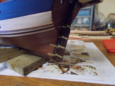

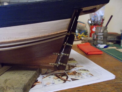

Thank you for the link and comments. It is not making a rudder that is the problem, it is 'hanging' it properly on the ship but, having said that I think I have it sorted. It seems the important thing is to fix the parts on the rudder first and the attach them to the boat.
