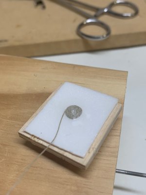

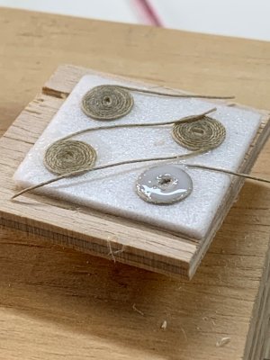

When tying guns or make rigging, many modelers fold the remaining rope into a flat circle (pancake). Please advise how best to do this.
Hi Elelid,When tying guns or make rigging, many modelers fold the remaining rope into a flat circle (pancake). Please advise how best to do this.
Hi Elelid,

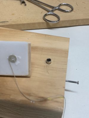

I wanted to get Flemish coils for my gun ropes too. The method I used was to create a mini turntable, 3cm x 3cm with a 3mm dowel in the Centre. I mounted this in a hole 3.2mm in a small block. On the surface of the turntable I applied double sided #M foam tape. Have some diluted PVA glue ready. Place the thread in the centers and apply pressure onto the tape, then carefully feed on some thread whilst turning the turntable piece. As the tread comes onto the flatened tape surface it sticks and continue until you get the dimensions you want. Once finished winding cover with the diluted PVA glue, allow time to dry and remove from the tape with a sharp blade.

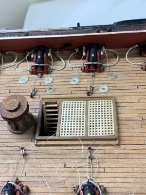

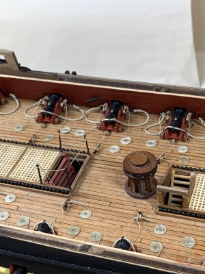

That looks amazing! Is that the Confederacy?Hi Elelid,

Hi ChelseafanThat looks amazing! Is that the Confederacy?
