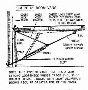

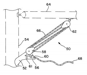

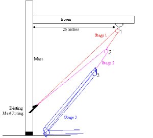

I found this info that I had stuffed back on boom vangs and rigging of the sorts. Can you post an image of the section you need help on, I can perhaps offer some tips. This is just the Boom vangs and not the rigging to add tension to the boom at aft. You will still need some arrangement of a block and tackle to attach to the Boom (gaff) at aft to add tension like you said. However, it is not evident if the block and tackle would be mounted a middle of deck or two of them mounted on each side of railings.
