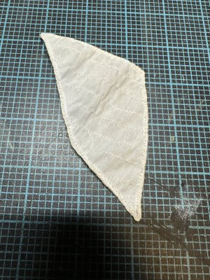

Five of the six sails are more or less done.
The two on the top need to be dyed brown and the two on the bottom will be dyed red. The one in the center, like the as-yet-to-be-stitched mainsail, while remain white. After dying, bolt holes and reefs to be added.
Having to wait on dying fabric so I’m forging ahead with the white sails. I’m not sure whether the correct term for attaching a bolt rope to a sail is ‘bending’ or ‘seizing’, but whatever the actual process is, I’m sure it bears no resemblance to what I’ve been doing. After about two hours, I’ve finished with the smallest of the six sails
I used fly-tying thread to attach the bolt rope and it’s practically invisible, it’s so thin. But the stuff has a mind of its own and is extremely difficult to work with. I still have much learning to do in order to avoid repeating my manifold mistakes on the larger sails.

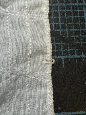

Once I finally got a system down for stitching the boltropes to the sails it proved to be not so tedious as I had feared. In fact I got in such a groove, I had stitched clear past the reefs before I remembered I was supposed to sew in cringles at the reefs.
I have some ideas on how I can recover from that, but tearing out the stitching and redoing it is not one of them. Other ideas are welcome.

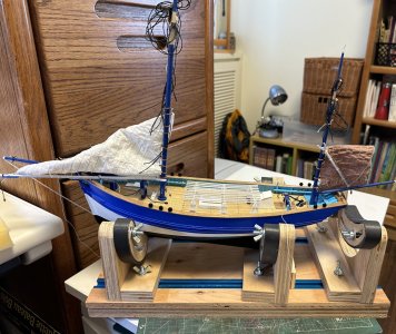

Having finished off the reefs on the mainsail, it was time to bend it to the mast
Although white thread would probably be more accurate, I used black instead because I liked the contrast between the wood-tone hoops and the white sail.

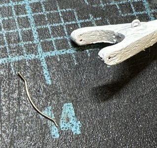

Since the running gear added to the mast previously would prevent me from sliding the hoops and boom on at this point I knew the boom wood be a challenge. After some thought, I drilled holes through each side of the boom yoke (jaw?), and then made a small slit in one of those. (Apologies for the rough, unfinished appearance of the boom. The wood with which I am working is pretty soft stuff. It looks a lot better at normal viewing distance.)
One end of the brass wire gets inserted into the hole, then after adding the parrels, the other end slides into the slot. The parrels are tiny glass beads.
And because overkill should have been my middle name, I then glued a couple of small slivers of index card into the slot. Those will get trimmed after the glue dries and should keep everything from coming apart.

Great solution for attaching the boom. Your sails look great also. One question - what is the purpose of the cringles along the luff if not to attach the hoops to?
Thank you for you kind words.
It took me awhile to puzzle out the cringles, but I believe those are where the sail would be attached to the boom when reefed. They are not aligned with the reefs in order to avoid putting stress on the reefs. I think the hoops would have been bent directly to the boltrope, but I went into the sail itself slightly to keep from ripping things apart.
You are correct. A little more research on my part bore that out. I knew cringles are used at the corners for attachment to booms and spars as well as for tack and clew lines. I think they can be used on the leech to help shape a sail as well. I just didn't realize they are also used for reefing. I am still learning.

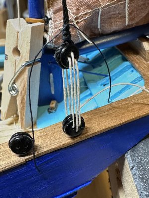

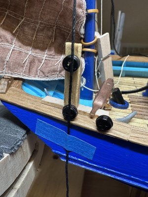

Because I found it necessary to mount the lower deadeyes to the rails I knew it was going to be a challenge to get consistent spacing between upper and lower deadeyes and getting nice tight shrouds. After much thought and aborted attempts at techniques in my books, I came up with a little jig that clamps to the rail and allows me to seize the upper deadeyes at a consistent height.
This is the result after the deadeyes are laced up.
IMG_5719.jpegNothing has been snugged down and secured until shrouds on both sides have been seized.
The deadeyes provided with the kit are not bad apart from the spacing of the holes being inconsistently aligned, which has really added to the challenge.
