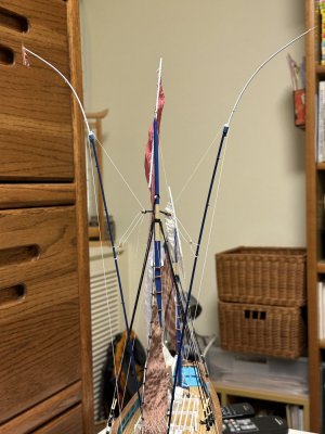

Preliminary rigging of the fishing booms is done, but everything still needs to be snugged down.
I was 100% right in not securing the staysail yet. I’ve moved that thing constantly while working on the other rigging.
Not so obvious in the photo, but the booms really have an amazing visual effect. Can’t wait to get the hooks and lines on, although I still haven’t answered the question of where to tie them off.

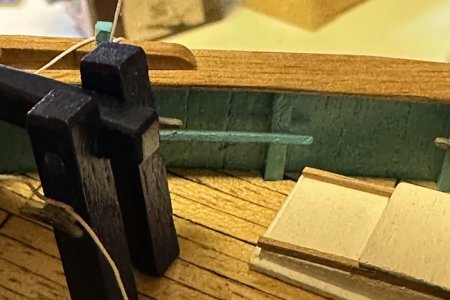

There is a rail on the bulwarks that would seem to be a logical place, but I don’t think it’s got the structural integrity.
The plans don’t show this being used for anything so it’s only glued on, but the kit wood is so soft and splintery, I don’t know if it will hold up to having seven fishing lines belayed to it.
I’m considering adding a brass bar to the top of the rail cap as a belay for the fishing lines.
The fishing booms look super cool!!!

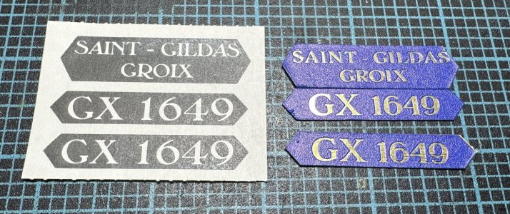

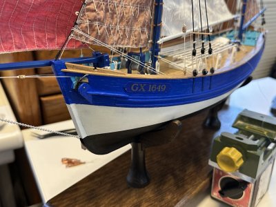

The kit provides stickers for the ID plates. I had the local print shop UV print them on small brass plates.
The one on the bottom came out a bit wonky, but if I can’t touch it up I’ll just put it on the starboard side facing the wall.

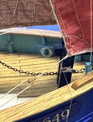

Staysail has been sheeted home at last.
The plans appear to have the standing end of the sheets going over the rail and through a hole in the bulwarks. I didn’t like that at all, so after considerable thought, I drilled a hole through the pinrails and secured the sheets to that.

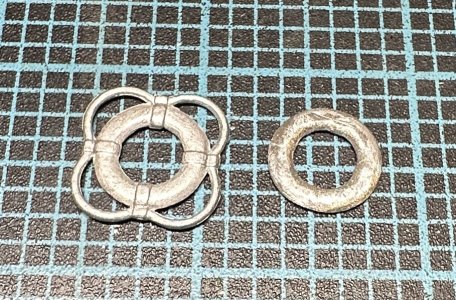

Nearly finished rigging everything except the fishing lines. One of the last details will be life rings. The brittania rings in the kit were decent, but I think I can kick them up a notch.
The ring on the left is original. The one on the right has had all the detail filed off. This will be replaced next.

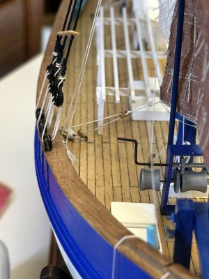

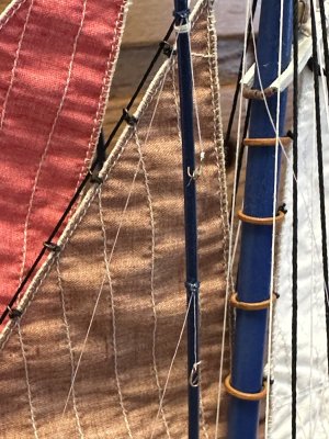

I have begun the laborious and delicate task of rigging the 14 fishing lines. Here are the first two hooks
Each line has to be belayed and dressed up with a tiny hank of fishing line
The latter task is like the worst game of Operation ever. To get at the rails on the inside of the bulwark, I have to work from the opposite side if the ship while threading the tools through all the other rigging. Maddening!
Oh, and here is one of the ID plates installed. I can’t manage carved and gilt letters and numbers, but this is a reasonable enough facsimile for me.
Hey Namabiiru,
That looks really great. It even looks like it was made for it and included. It couldn't be better. really nice. :DThumbsup
Best regards
Günther Ship-1

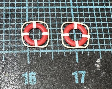

Here are the re-made life bouys.
Far from perfect, but an improvement over OOB. I throw myself on the mercy of the court to render verdict on which will go better on the viewable side of the ship. The other will be mostly obscured be sails and rigging. Voting starts now.
Hey Namabiiru,
Once again you can see how nice it is to realise your ideas by hand. Really beautifully realised. Great lifebuoys.
Cheers
Günther Ship-1

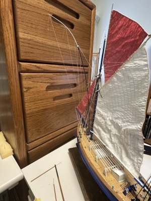

Fishing lines on the port side are done
Not quite as tight-looking as I wanted, but the boom has got so much flex to it that a small adjustment on anything has an impact on the geometry of everything else
