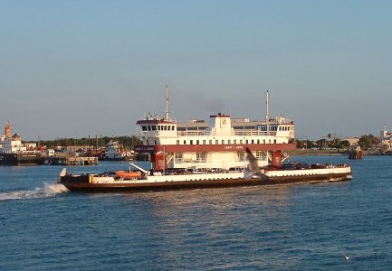

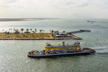

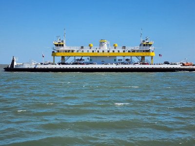

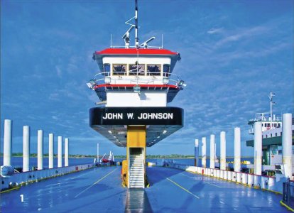

And now some of the ferries and landings over time:

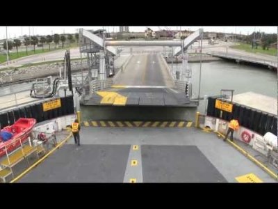

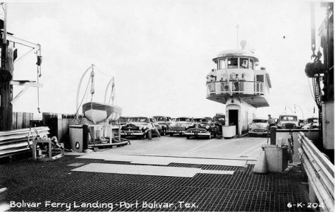

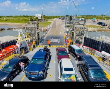

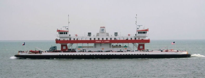

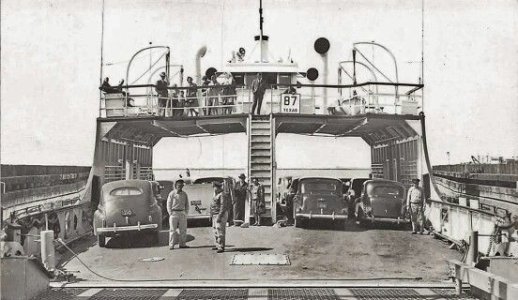

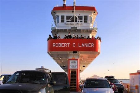

db6f70a86933a5735cae821d9499a555-1643866674.jpg24d8b18a0a851a6af4bb7378097689c6-4110317317.jpgDSC4969-2264683871.jpghqdefault-3903978589.jpgBroadside 1.jpgBroadside 3.jpgJJohnson end view 1.jpgLanier end view 1.jpgport-bolivar-tx-usa-july-23-2023-photo-of-the-port-bolivar-to-galveston-free-ferry-2RG8R40-331...jpg
I rode the older boats the most - OK, NOT the Galveston and Jefferson! :p - including the Gibb Gilchrist, when I lived in Houston or was in college and the beach house was still a regular weekend trip. After moving away, I rode the Lanier, Greer, Stoker and Dedman less often but I've never ridden the John W. Johnson or the Andrade.

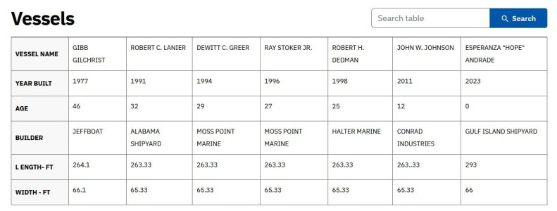

Here's TxDOT's list of the current fleet. Look at the middle five. Built at four different yards over twenty years, and every one of them is exactly 263.33' x 65.33'. They're sister ships, all built to the same design, double-ended with a pilot tower at each end, and that's the class I'm building. The Gilchrist is an older design, and the Andrade is the newest.
So why the Greer? Dewitt C. Greer earned his civil engineering degree from Texas A&M in 1923 and went on to serve 27 years as Texas state highway engineer. Texas A&M is my alma mater too, so the choice was easy. Paint a different name on the fascia and she'd be any of her sisters.
