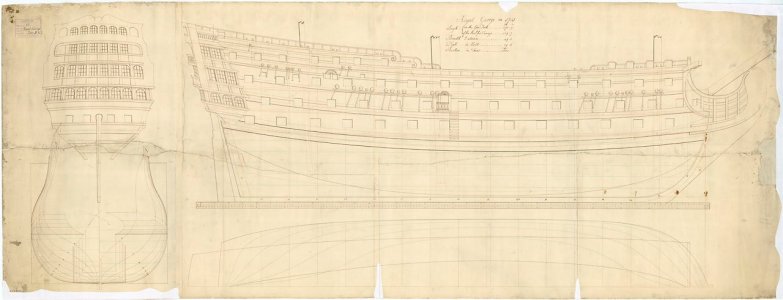

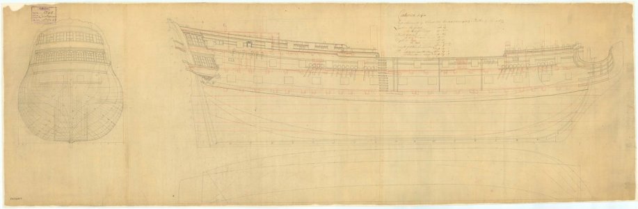

Royal George 100 1715
O 06
L 15
171' 9" x 139' 7" x 49' 3" x 19.5' 1800bm
Commissioned 1741
No noteworthy activity
BU 1767

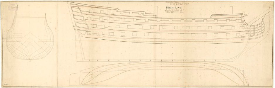

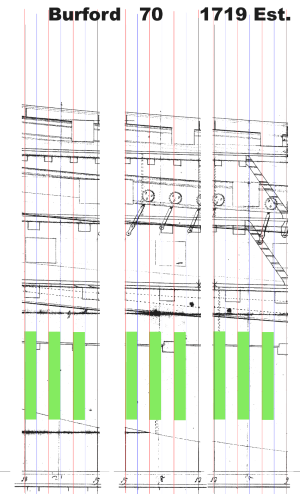

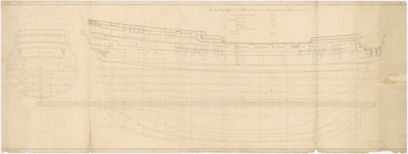

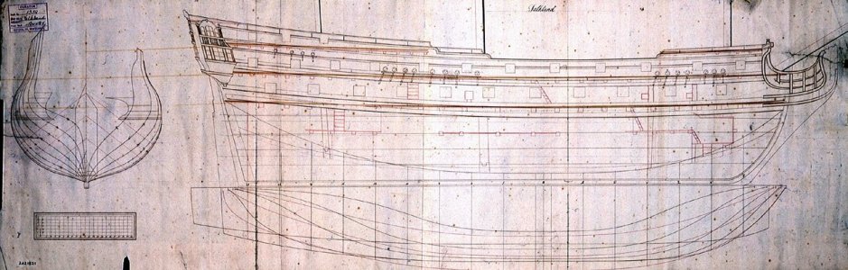

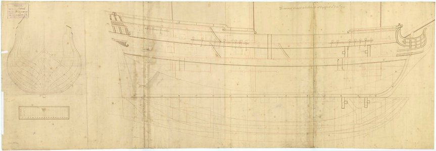

The plan is ZAZ0046

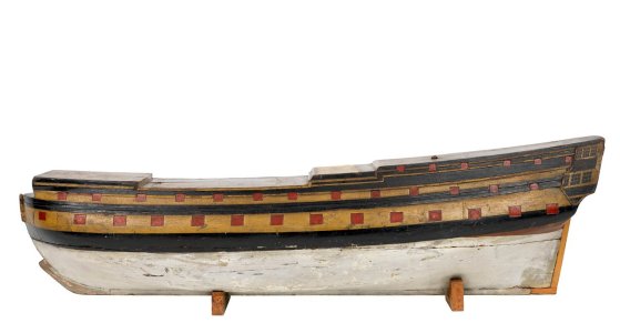

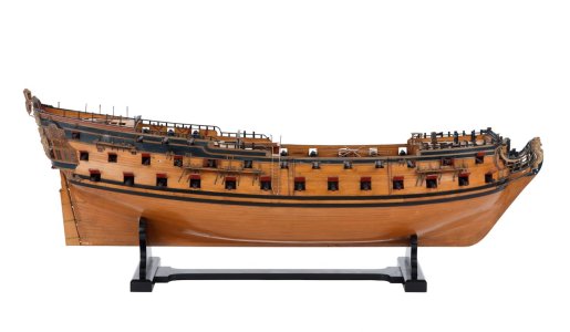

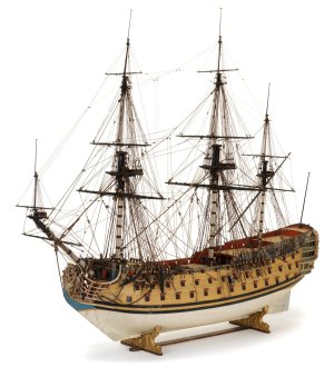

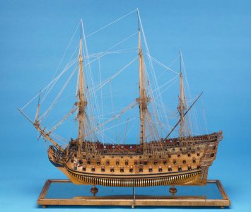

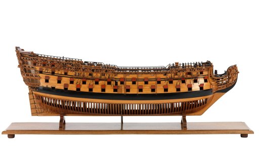

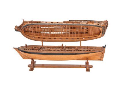

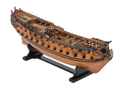

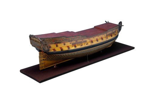

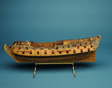

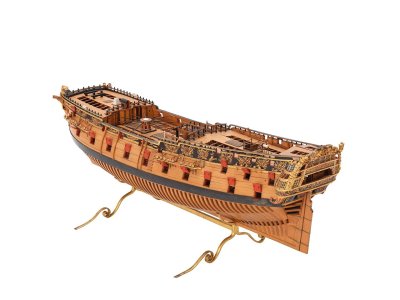

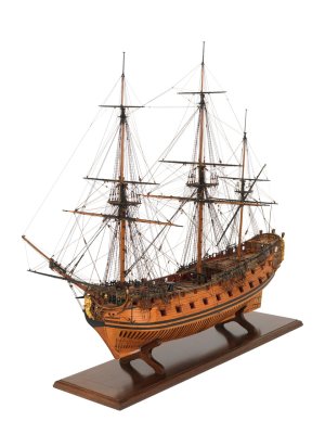

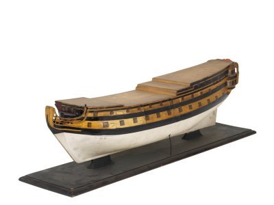

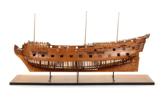

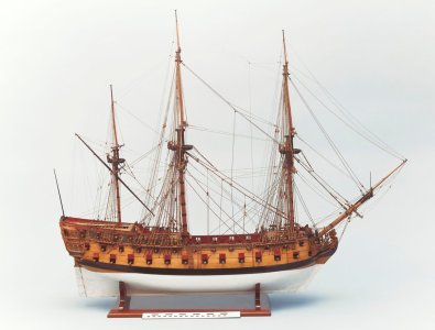

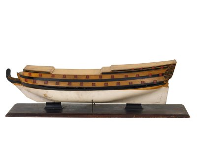

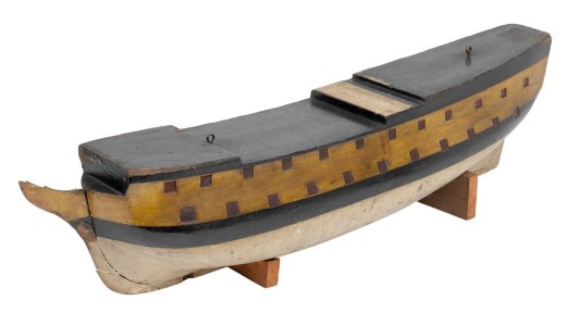

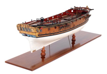

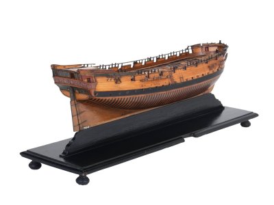

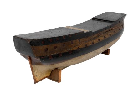

There are models of the ship

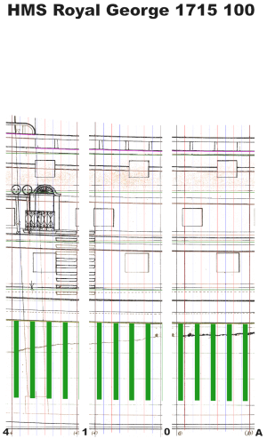

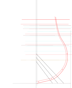

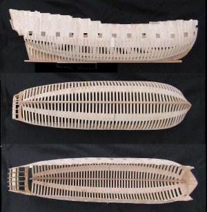

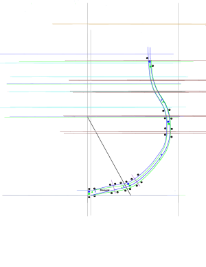

As an example of what can be done with the plan I will display what I did with it.

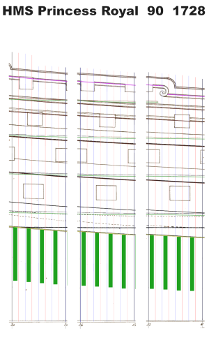

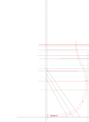

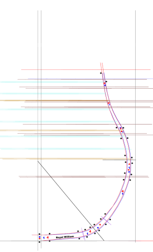

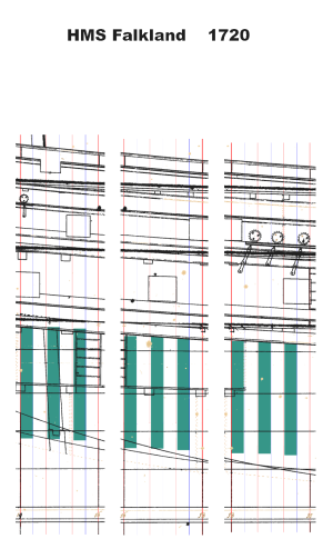

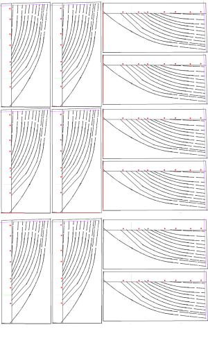

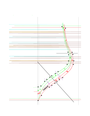

This is my midship framing plan and instructions.

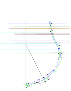

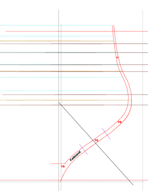

The station frame shape

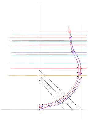

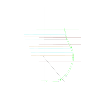

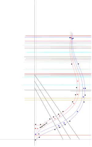

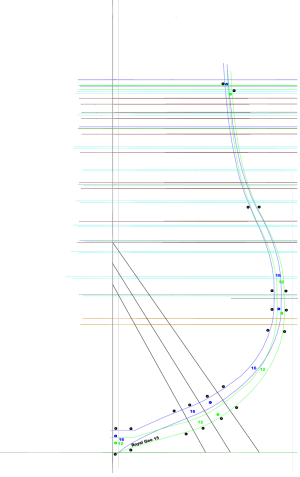

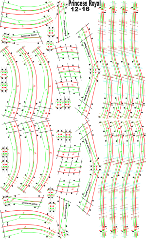

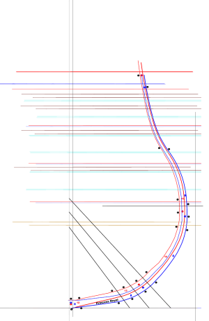

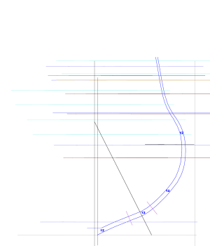

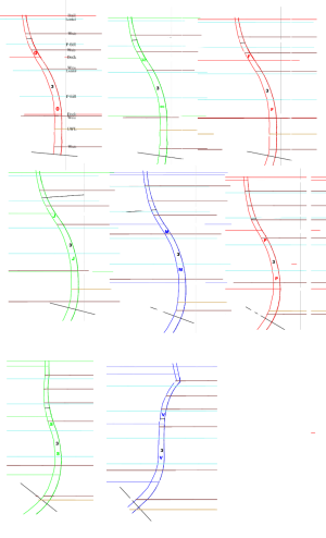

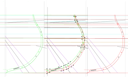

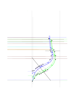

A midship station layer shape

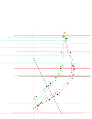

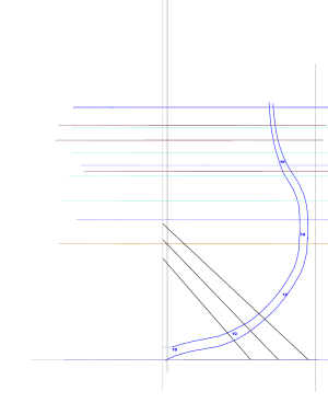

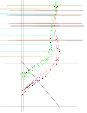

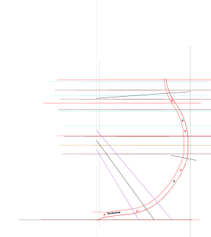

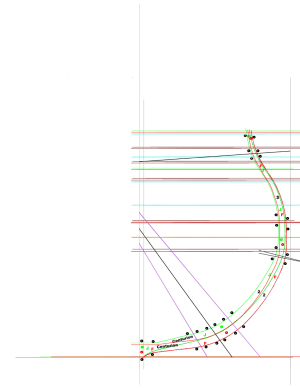

A station layer shape where the bevel gets interesting

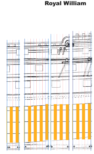

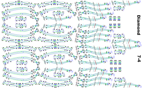

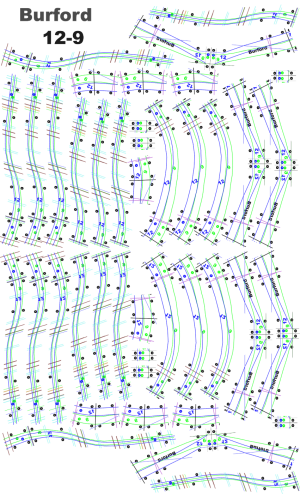

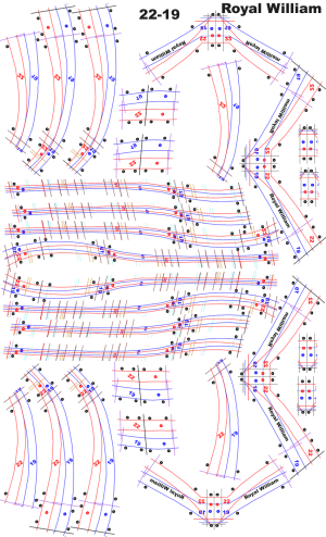

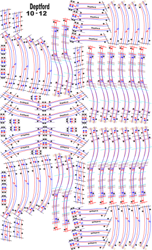

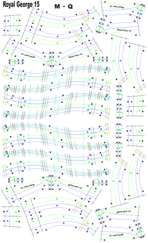

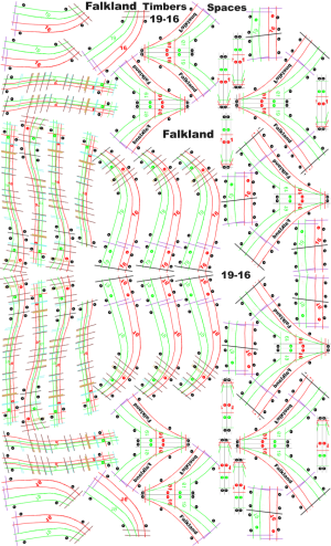

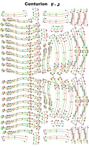

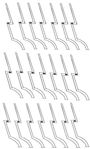

A page of timber patterns
