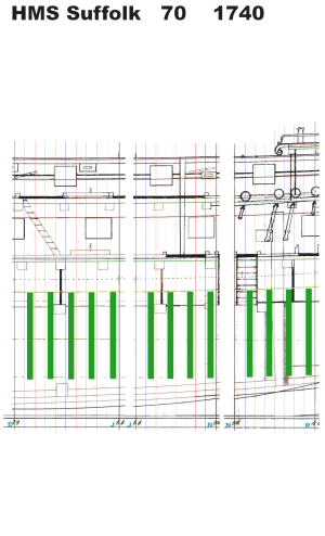

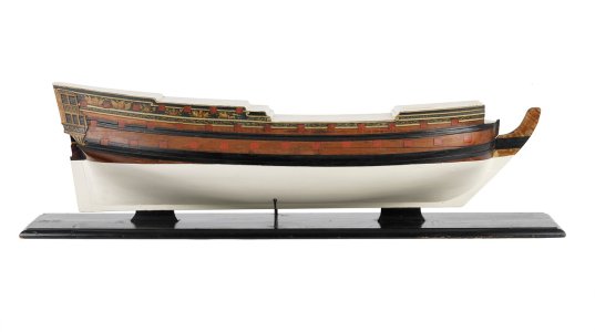

1733 Establishment
Suffolk 70 1739
151 x122 1 x 43 5 x 17 9 1224bm
O 35
K 36
L 39
Sister ship
Elizabeth 1737
Essex 1741
Prince Frederick 1740
Nassau 1740
Bedford 1741
Royal Oak 1741
Revenge 1742
Stirling Castle 1742
Captain 1743
Monmouth 1742
Berwick 1743

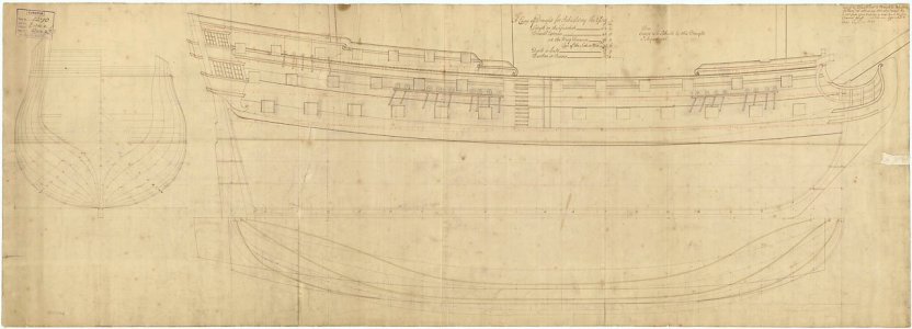

The plan
ZAZ1434
Other plans
ZAZ1364 WIKI
ZAZ1375 WIKI
ZAZ1393 WIKI
ZAZ1392 WIKI
ZAZ1355 WIKI
ZAZ1437 WIKI
ZAZ1368 WIKI
ZAZ14380 WIKI
ZAZ1433
ZAZ1436 WIKI
ZAZ1437 WIKI
ZAZ1438 WIKI
ZAZ1514
ZAZ1515
HIL0162

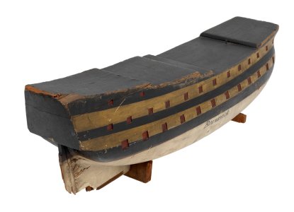

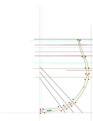

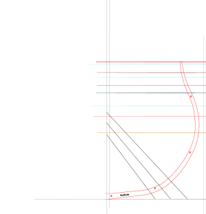

Models of the ship

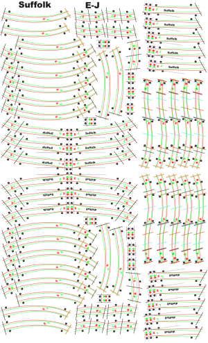

Stations not at regular intervals
R&S varies
Floors varies
This is my midship framing plan and instructions and lofting steps
Suffolk Station frames 2.pngSuffolk HF 48 E .pngSuffolk HF 60 E-J.pngSuffolk Timbers E-J ii .png

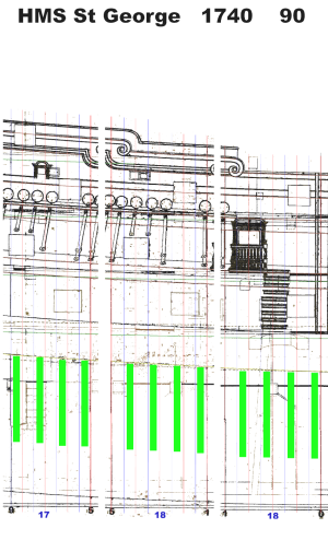

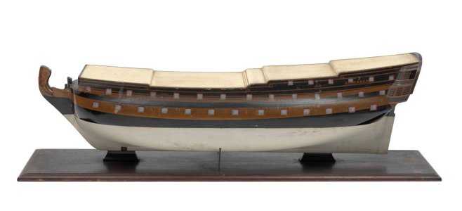

1733 Establishment
St George 90 1740
166 x134 11 x 47 9 x 19 6 1623bm
165 9 x 134 x 48 3 x 19 6 1655bm
O 1733
L 1740
Routine fleet and flagship duties
trial of Adm. Byng 1756
BU 1774
Sister ship
Duke 1739

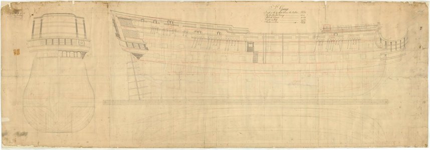

The plan
Other plans
ZAZ0220 - Duke full size @ WIKI Commons
ZAZ0177
HIL0039
HIL0040

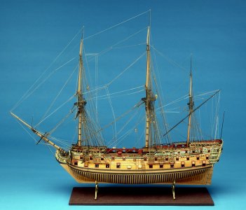

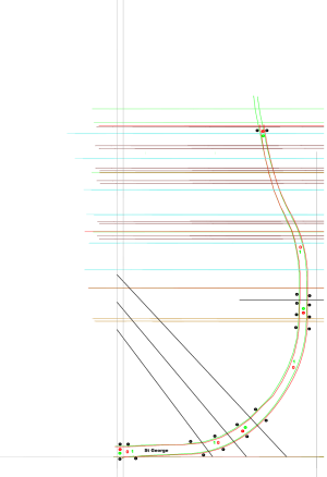

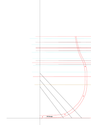

Models of the ship

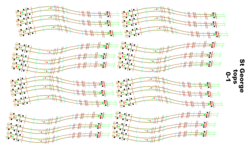

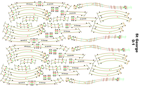

Stations
R&S 31"
Floors 18" - 17.1" - 16" - 14" - 12"
Stations at irregular intervals.
St George Station frames 4 .pngSt George HF 48 0  .pngSt George HF 0-1 .pngSt George Timbers 0-1 ii .pngSt George Timbers 0-1 tops ii .png
