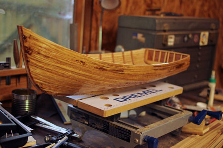

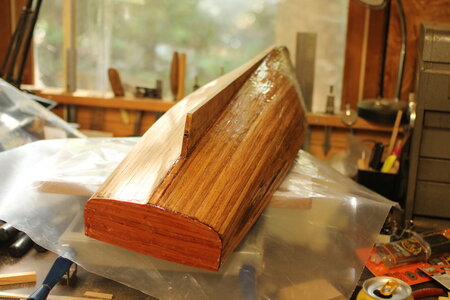

I have managed to absorb a lot of excellent advice from many kind responses. I have finally completed the planking for the Donald David. Photos attached. I have a very long way to go, but this is a major milestone for me. Many thanks to all who have provided help/opinions.
Happy modeling.
Steven
