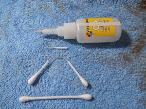

You are correct in saying that it can affect the absorption of stain. However, if you apply it carefully this is not really an issue and the trick is to use a really thin nozzle and for this I make my own. See the photo below and, working from the bottom -
a. Take a cotton wool bud / Q-tip.
b. Pass it slowly backwards and forwards through a candle flame (I use a tea light) whilst pulling both ends outwards until it stretches thin. Keep the pressure on it until it hardens up (just a few seconds). This takes a bit of practice, but stick with it, a common mistake is to get too close to the candle flame.
c. Cut to length.
d. Drill out the top of the bottle to the same diameter. insert the nozzle and wrap a small strip of Blutak around it to seal. If after some use the end gets a bit claggy simply snip it off and carry on like that until you need to fit a new one - the old one might need pulling out with some pliers, but it always comes out cleanly.
There you go - dirt cheap, an endless supply and I have been making them for years.

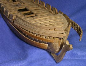

I used CA and epoxy glues but found out these types of glue sometimes react to the oils and resins in wood and the glue will break down. I am not saying all CA and Epoxy glues react to all types of wood but it is gamble to know if the wood and the glue used is compatiblewrong glue.jpg.
Now I only use wood glues or a year or so down the road you will end up with this. Piece by piece this model fell apart
The same thing can happen using PVA or “wood glue”. It’s not the adhesive so much as the wood. Glue bonds with wood glue like TiteBond will fail if susceptible wood isn’t pretreated. I scrub the parts down with acetone to remove the oily residue in ebony, rosewood, blood wood and most exotic species. Maple,oak,cherry,bass,box and pear are all OK - very low or no residual oils.
