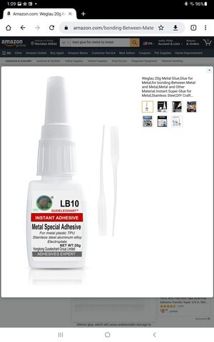

Based on this discussion about possibility of glueing metals I decided to make a try and searched for some glue on german amazon, ordered and just received thes two bottles - When I have some experience with the results I will share with you the information

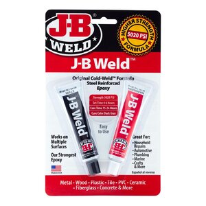

Try J-B Weld epoxy. Works first time, every time, on metals/metals or metals/wood or metals/plastic or resin, and the bond lasts forever plus a day. :) My dependable go-to for such applications for over 30 years now.
J-B Weld is fantastic but there are two downsides - color is very close to black regardless of their advertising that says grey and the second is the very slow dry time - even their (kinda) fast stuff. I generally leave anything J-B'd overnight regardless of the variety.
My Starbond dries to handle in seconds and cures completely in an hour, usually less and so far has worked 100% on brass to brass and brass to wood

VERY slow drying time - 24 hours. Which Starbond product do you use?

Medium, thick and extra thick on hand but seldom use anything but medium. I have some LocTite gel but that's just a back up but works well tho can be messy. Oh and I have some Bob Smith's as well - thick.
