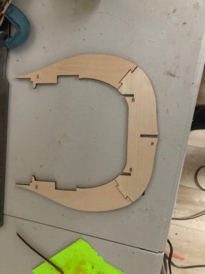

Allo everyone,
Am I crazy, or gluing laser cut pieces is hard because the glue does not stick well on the laser burnt cut?
I'm building a frame right now, it's not the first one, but I keep seeing jointed parts separate?
Help anyone?
use needle files in the joint. You will find the triangular file to fit great most likely. :)
The other option would be to glue some scrap on the outside, overlapping the joint.
there is a thread here on SoS that tested different glues
Thanks a lot!!
In my experience it is not necessary to get all the char off. Just a light sanding or filing as Corsair suggested will often be enough to get a good join without distorting the parts.
