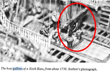

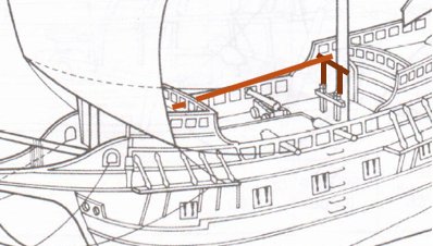

After consulting various books, I may be wrong in saying I rarely see them on models. The first gallows picture I saw looked like a substantial frame, and I rarely (if ever) see those. But further reading reveals that often they were just a couple of vertical spars above the bitts/knight in front of the main mast. This picture is from Lavery's book "Arming and Fitting..."

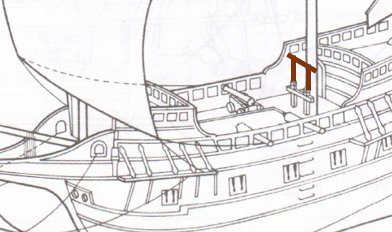

So I can add three spars (two vertical, one horizontal) on top of the bitts in the kit, like this:
Then according to various references, spare spars (and the fish davit!) were laid with one end on the gallows and one end on the rear of the forecastle, like this (I assume):
For realism I would add a couple of planks or something as well...
Advice or comments?

As it was mentioned above, the model is yours and you can do anything - even the gallows, even mutineers hanging from them! :D In my opinion, the idea above is a complete fake, but the decision is yours. I would say the main problem is that you try to put a much later/bigger ship's fish davit on the Golden Hind while you should not. This makes you bring more and more stuff from later periods and make something that never existed. It is just my opinion and I might be wrong and it is up to you to decide.

But there was a davit?
What would you do?
I want to learn what was most likely, and then decide.
What would you do?
I would say there was no davit as such a small ship don't need it. If there was a davit, it would be 98% of time useless, so it would rest somewhere, where it does not make any trouble: with the other reserve spars (picture from Lavery's book is for later age ships, when there were reserve yards and top-gallants and the boat above them). I would put it under the deck (with other spars), on the deck as you did above or on rails, for instance. Or, maybe, since you already did it, I would show it in use - in the process of fishing an anchor ;)

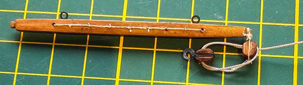

Hi Boatman (and others)
You may well be right! I keep forgetting how small the GH was. And the anchors were also correspondingly smaller so I think you could be right. It may have had no davit as such. Normal stay tackles or load tackles would probabaly have done the job just fine!

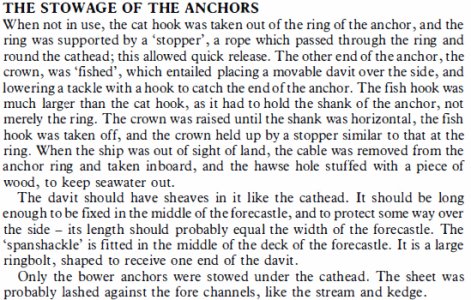

The closest comparison I can find is the Susan Constant. Same period and similar size. It did have a single movable davit, which is basically where I took my design from. Here is an excerpt from Lavery's Anatomy of the Susan Constant:
The diagrams in that book show sheaves in the davit, but I went with a tackle attached to the end, as shown in some other references.
I think that, given I have made a davit, then I will use it. I had also thought of putting it in place, actually fishing an anchor. It might look good! But there are two things that made me decide against that:
  1. I think it then needs a couple of figures to give scale and show that it is "in action". But getting figures in the correct pose might be hard, and painting figures is not my strength, and I think that a badly painted figure spoils the whole thing...
  2. My davit is too long! I followed the general rule of making it about the width of the ship's waist. But I note that Lavery, in the Susan Constant book, says "about the width of the forecastle' which would have worked better. I put the spanshackle in the middle of the deck (as on the Susan Constant) and if the davit is held there, then my davit extends too far over the edge. So I would need to make it shorter, which is also probably more realistic.
So in the end, I will lash it to the eyebolts that are also holding the ship's boat in place (as shown in an earleir post). This is a reasonable compromise I think. And the davit looks OK so it will add visual interest to the model.

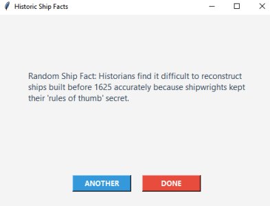

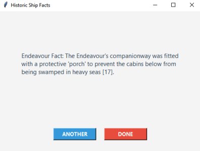

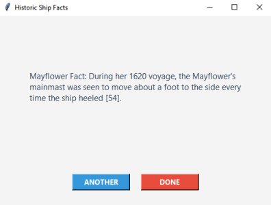

I have continued fooling around with my AI Agent. I got it to write two programs (in python).
  • Ship Facts: It has a list of facts and randomly shows one whenever you run the program :-)
  • Ship Dictionary: It gives you a word and then you ask for the definition, to check if you had it right. It has 203 words at the moment. (Many from Falconer's Dictionary I suspect; and we can add more if we need!)
Here is some sample output from the Ship Facts program:
