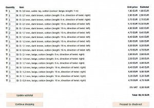

G'day Zoly, I normally make my own ropes but things have been a bit hectic and I decided after seeing your post about these ropes to buy some for my 1/48 Royal William, I filled out the order list of the ropes that I needed but as you said I could not go any further so I sent them an email to which they replied very quickly, cut a long story short, I ended up putting in the shopping cart all the items I needed, then I saved the list and sent it by email to them, I will attach the list so you can see what I've bought, because it was over 45 euro's there was free shipping and no VAT or GST as we call it here in Australia, I am waiting for the package to arrive and will post close up pics of the ropes, which they make in right and left hand lay,
The total order with the free shipping came to AUD 160,
best regards John.

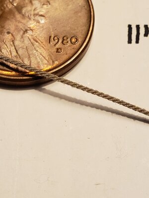

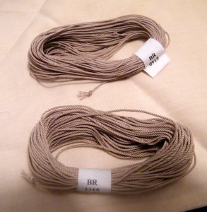

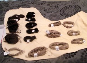

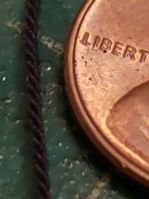

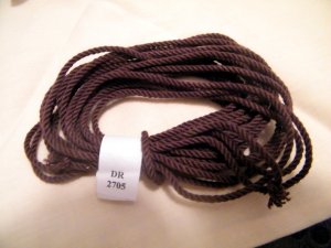

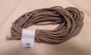

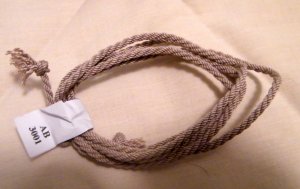

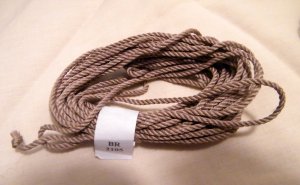

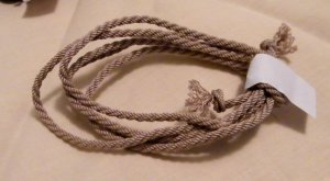

G'day Zoly, they arrived today, nine days from Germany to Australia, I'm over the moon with them, the first twoo letters on the label are the diameter, and the second two the length in meters,
PS any questions just ask.

The ropes are looking great, real superb quality and service....I will try them also ...... and many thanks to Zoly for this hint.

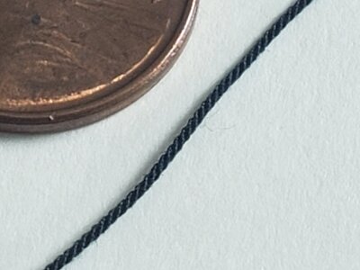

p.s., adding photos of some recent batches with the Rope Rocket (using Gutermann Mara 100 poly thread)
