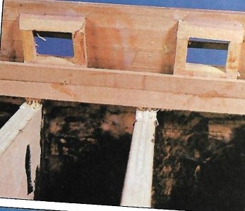

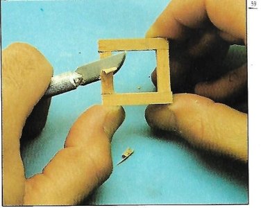

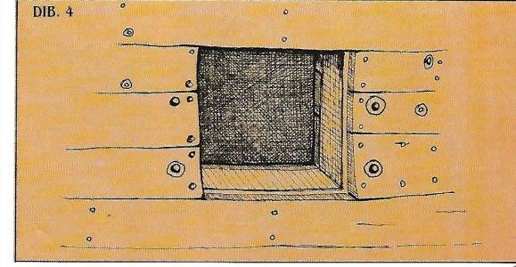

Helo to all. I am little by little coming back It is quit difficult to start again- where , what etc. but i justsa this mail this morning -so not to late to answer. I have over my many years made a lit of -open gunports -not as the gun poer not ppenet and the frames-many time od plasst "Billing Boats".I general usrd a 4x4 pieve od wood to be glued together. Generally about 2-3 mm above the min deck, and then glued to a Bulkhead.I will add some images
I have many more and more detailet -when I find them.
mut this are a start
el capi

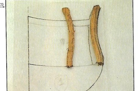

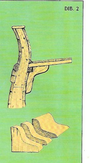

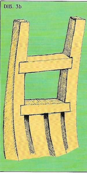

hi. I finally found my old images of "how to make a gunport" This is from a grup build back in the 60beginning 70. The total build "A Spanisf Fregat" can be found some 20 years later.

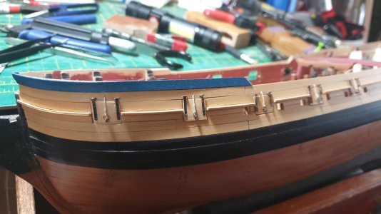

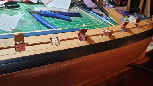

Hi, I'm building the HMS Ontario and am having lots of issues.
In the meager parts list it says, gun ports and sweep ways 3 x10 lime 100cm but it looks way off to me.
Am I missing something here? I sawed one in half, so basically 5cm wide and it still looks too wide.
Thanks Neil

Hey Neil,
in my opinion, gun ports always seal with the hull, otherwise water can collect in the corners and be pressed into the wood. This would make them leaky and, if there is no sealant there, they would start to rot. Question:
Could it be that you have fitted them the wrong way round? It looks like you've attached them from the outside in the picture. If these gun ports have this width, then they must be planked inwards and either planked with the frames, then they are no longer visible but flush, or you sand them down completely to the planks.

Looks like to me he has mounted them on the outside of the hull.

Hi Dale
A few do look they are not fully seated against the stops inside the ports but basically it looks like he built the port lids as they were designed, with outboard layer of planks horizontal and matching the hull planking while the inboard layer is four boards usually about 1.5" thick in the vertical plane.
