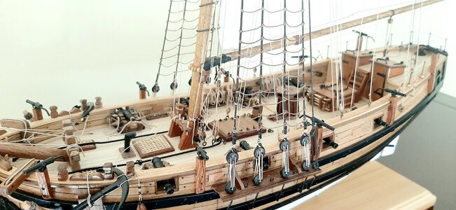

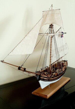

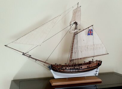

just some pics of my near complete hms sharke scratch built from plans by mantua. cannons and figurehead ordered from cornwall model ships. 2 more sails to do and some rigging, and a ge20211024_154124[1037].jpg20211024_154243[1033].jpg20211024_154441[1030].jpg20211024_154431[1031].jpgneral cleanup and she will be finished. please let me know what you think of her so far. when done i will put in the completed builds section.

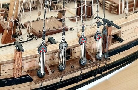

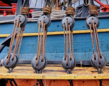

Especially because you asked, I have a small comment, and I think it could be adjusted with some small additional work.
I think your alignement of your deadeyes is not correct everywhere ( the lower row is correct) - one of the three holes should be on top

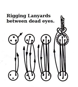

28f4a587542388d859c1a36fcc2a45db.jpg triple-deadeyes-and-lanyards-on-hm-bark-endeavour-tony-crehan.jpg
I made some red dotts where the holes should be - also the rigging of the lanyards could be followed by the first pic

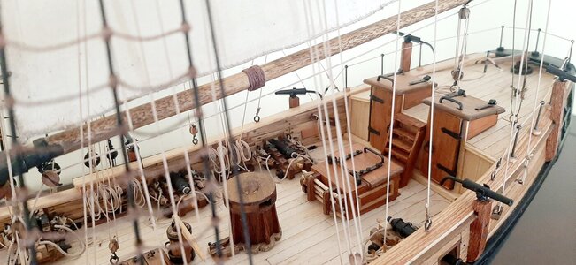

Great job on the sails. Could you please give us an idea of the steps you take to produce them?
I make them the same way as on the master korabel you tube video. i dye and cut the sail cloth to about 1/3 more than the actual size and depending on the scale use an 1/8" overlay and diluted white glue. when dry i cut to size and add the additional sail parts and give a light spray of poly. As this is a 1/48 scale i hand sew the bolt ropes and install grommets where the halyard , downhaul and sheets will be attached. i have tried other sail making methods, and this one gives the most consistent results.
Finished the rest of the sails and the general clean-up - touch -up is complete. i will post some pics of her in the completed build section as soon as i get a decent base and the small plaque i ordered arrives.. Don, very scenic up at Campbell River. A friend of mine was up there this summer whale watching. I was up there a year ago in september, but the smoke was so bad that i couldnt even see quadra isle from the hotel balcony.
