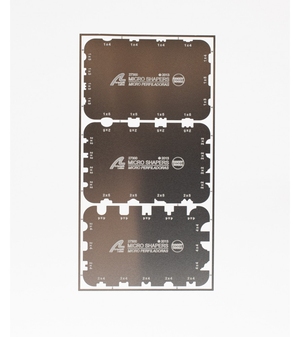

Try one of the Micro shapers from Artisania Latina. You can use a regular strip of wood to make half round over.
https://artesanialatina.net/en/micr...-plastic-models-miniatures-8421426273007.html
While they work pretty well on basswood and softwoods, they are a little hard to use on hardwoods. I find it easier to round over a length of board on its edge then rip the half-round strip off on the tablesaw. And it is much easier rounding over because it is easier to secure the board in a vise instead of trying to secure a long, thin strip while scraping.....just my thoughts...
