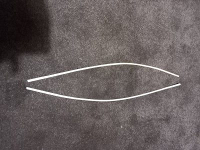

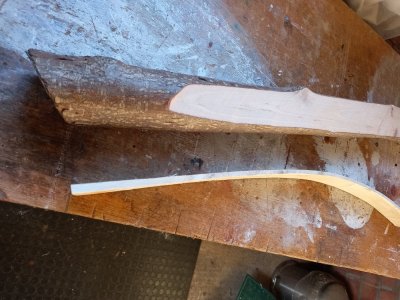

First I took a stave I cut some years ago for a plant support and sawed a billet lengthways. |The wood was white, very close grained and hard - which surprised ne for a relatively fast growing tree. (photo 1 upper)
I then cut a fresh stave from which I extracted a plank 5mm thick. While green I clamped it into an arbitrary curve. After a week I found that it had retained its shape. (photo 1 lower) From this piece I cut a couple of ship planking strips 2mm thick. Photo 2. These were very flexible and, after soaking, even more so - including edge bending.
