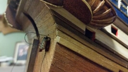

The light colored wood is "hull planking" and is used to make the first layer of planks over the frames to create the shape of the hull, as Zoly said. The darker wood strips are for "finish planking" of the hull. After the hull is completed with the first layer (light), and is sanded to proper shape, the finish planks (dark) are used to plank over the stern frame first, then the sides of the hull after that. The reason for that order is shown below.
In the example of a French man of war, you can see that the ends of the side planks overlap the ends of the stern planks. So, plank the stern first. The ends of the wales are also flush with the surface of the stern.
