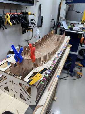

Hello fellow newbie and Sox fan! I can't say I have anywhere near the experience of many of the gentlemen here have have, but I can share some reflectings of my own stumbling around in this hobby. I agree with many others in that ships are not to be taken lightly if you haven't worked with them in the past. But, if you're stubborn, passionate, and thorough, you'll figure it out.
I started with a popcicle stick and dream. Well, perhaps that's an exaggeration, but not much of one. Below were my starter tools and though I've expanded my arsenal a bit since, it's still reserved to small, inexpensive hand tools.
I'm a year into this hobby now, and am still currently working on my first build. I've made more mistakes than I can count, had to start over, made more mistakes, but don't they say failure is the best teacher? And this is where I'm at now.
It is perfect? Hell no! Is it half as good as the builds that appear here daily? I wish. Am I close to done? I tell myself I am every week. I joke around about how I'm doing all the time, but ultimately, I'm actually quite proud of what I've been able to achieve so far for a first build and the bare minimum of tools. Even the wood I'm using is cheap basswood from Hobby Lobby, but, hey, I make it work for my budget.
My point is, when you're not sure where to start, just jump in and start building. You'll make mistakes, but you'll learn more from them. But the most important thing I can say is this: choose a ship you love. I cannot emphasize that enough. A ship you're passionate about because, at the end of the day when you want to take everything you've done and chuck it in the trash, that love and passion will be what keeps you going. Anything, from a dingy, a ancient Greek galley, or even an advanced ship-of-the-line. And while you build, research! Youtube has been a great friend when it came to things framing or how to properly shape planks. Articles, books and photos will help you learn more about the ships. And yes, the forums themselves do help as there's always helpful techniques to learn from them.
Forgive my ramblings, but I look forward to seeing on whatever you choose to be your first build!
