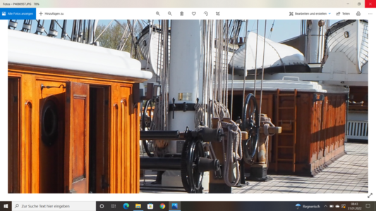

I think he means this mast band with belaying pins.
Photographed 04/2017.
I would solve the problem this way without having to solder.: Bend your own hoops from a sheet of brass, glue them to the mast, drill holes, glue in eyebolts and slide securing pins into the eyebolts.
Best regards
Thomas
Thanks. What I was talking about is the lower band for the lift tackle. It is barely seen below the winch in the above picture. You can see the tackle, though.
Thanks again,
Jim
