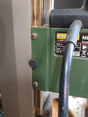

S stuglo Joined Aug 21, 2019 Messages 762 Points 403 Aug 29, 2022 #1 A few days ago, I noticed some 1mm play (vertically) between the Main Housing and Z Pillar. ? diagnosis and treatment I can try a home. I use it daily, and don't want to send it for repair.

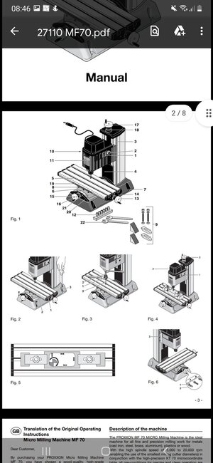

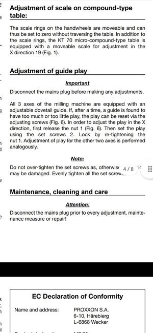

Maarten Staff member Forum Moderator Joined Sep 10, 2017 Messages 3,938 Points 678 Location The Netherlands Aug 30, 2022 #3 See here the adjustment of the guide if that is what you mean. In the handwheels you will allways have some play which is normal.
S stuglo Joined Aug 21, 2019 Messages 762 Points 403 Aug 30, 2022 #4 Just found solution myself - adjusting screws on side of pillar -No patients -ADD But thanks for posting
S stuglo Joined Aug 21, 2019 Messages 762 Points 403 Aug 30, 2022 #5 PS - if the adjustment screw are (too?) tight, this results in play in the handwheel.
Steef66 Joined Aug 8, 2019 Messages 4,142 Points 688 Aug 30, 2022 #6 stuglo said: PS - if the adjustment screw are (too?) tight, this results in play in the handwheel. Click to expand... This is because the plastic cap (18) that holds the wheel is dented. There is backlash on that axle anyway. Another approvment is this overview - Can you get the most out of your Proxxon MF70? I send an e-mail with the question if they deliver to the USA below 2 kg. We wait. Stephan, I am wondering if they ever respond to your querry? shipsofscale.com
